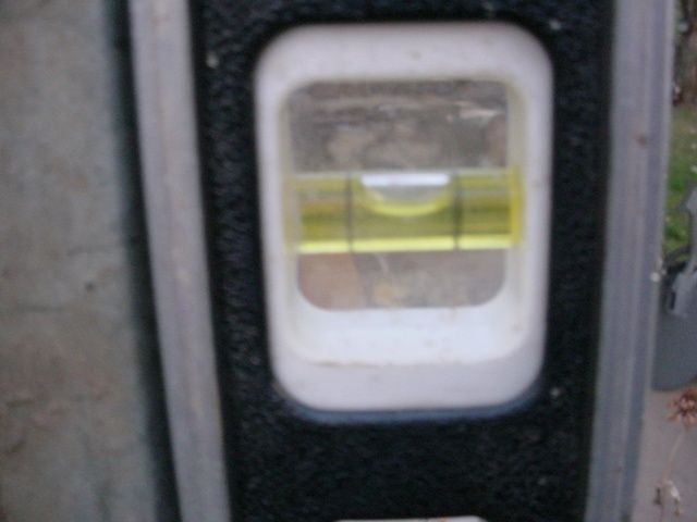

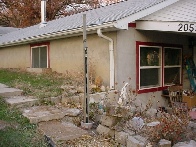

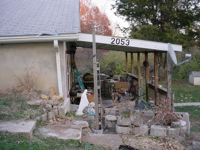

I installed a pole in the ground for future fta stuff.:D It was a little dark outside when i leveled the pole. I filled it with cement, a good tip :eureka is to bolt a ubolt on the pole to keep it from rotating. But my question is, :what when I leveled the pole ,the bubble is between the lines [0], but the bubble is not PERFECTLY in center of those two lines. How bad will this make my signal? :river I added some pics to show what i mean. :eek:

I think you'll be fine if that is your level line all around the pole.

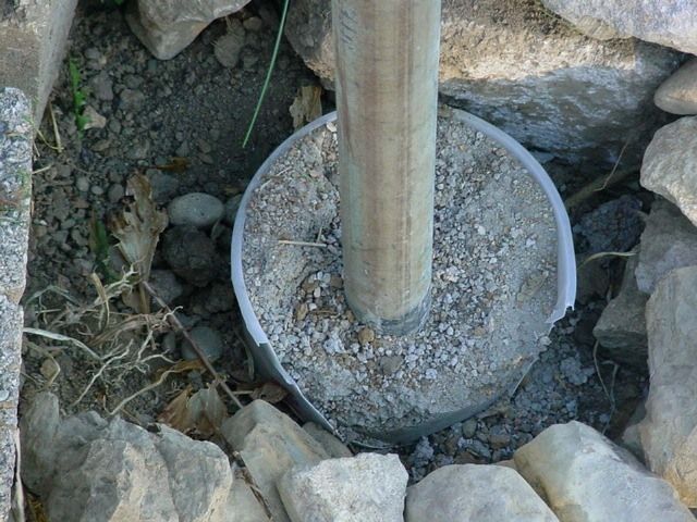

My pole is wobbly!

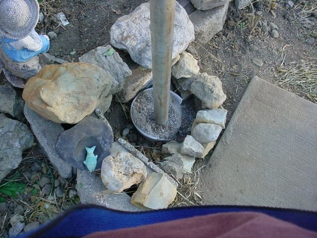

I installed a pole in the ground with 90 pounds of cement but. It still wiggles at the top of the pole! Can i just fill the tube with cement?
I know its childish, but the subject made me laugh..
I've been in the same boat where I installed a pole and it would shake near the top, it didn't kill signal unless I stood out there and wobbled it the entire time.. as long as it's not on top of the basketball pole you might be ok.. :p
Idea about pole.

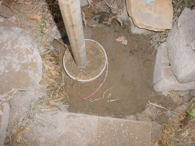

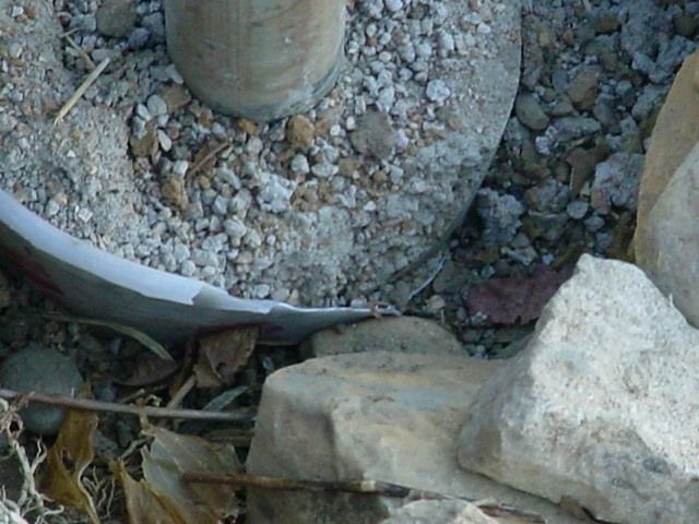

I installed a pole in the ground with 90# of cement. Yet at the top and bottom it sill can wiggle. I am wondering If filling the pole up with cement will fix the problem. Also at the base of the pole there is a little wiggle because there is a tiny gap around the pole. I am wondering if I can get some cement and use a screwdriver or a Popsicle stick and cram cement in this gap? Give me some advice please, I also threw in pictures to help.
Dont Worry
I cut the bottom out of the bucket and slid it over the pole to give it a mold, there is 2' of cement or more under it.

I installed a pole in the ground. It is not perfectly level the bubble is between the lines but no DEAD center. How much will this affect signal? Also my pole is slightly bigger then the normal dish/directv mount. Will the 3ABN dish need a bracket of some sorts?
If this is the same pole you already asked about and had a pic of in another thread, then like I said, I think you'll be fine. Every dish setup needs a little tweaking and your's will be no different.

Typically, the more your level bubble is off, the worse the issues with the motors. For non-motor mounts, you should be able to tweak and make it ok. Shucks, when I was originally starting out and didn't have a motor at all, I just wired a little 18" dish to a pole on my porch with some cheap copper wire and it just sort of hung there kinda almost blowing in the wind. Basically, tweak as well as you can, and once you nail the signal, figure out a way to make the dish stay put there as well as you can. In the end all that really matters is that the lnb is aimed the right way. If you are going with a motor, you may try leveling the bubble just a smide more, maybe with some support wires attached to the ground (or roof if this is a roof mount)... I had to add a few support wires on my setup - just a couple extra little wires to help stabilize the dish and bring it level more prefectly. I used to have the same leveling problem you seem to be talking about before that.
I would guess that no body has ever set a pole EXACTLY plumb. But It needs to be close. Play around with it a couple of weeks and if you still don't have a signal you may need to replumb it.
I always try to make my poles as plumb as possible, especially important if your motorizing the dish. If it's stationary you can tune out the tilt but the scale on the dish will be off, then again alot of those markings are off already :)
One thing to remember when setting up a dish. Try to do everything as exact as possible, It will save you hours of headaches.
