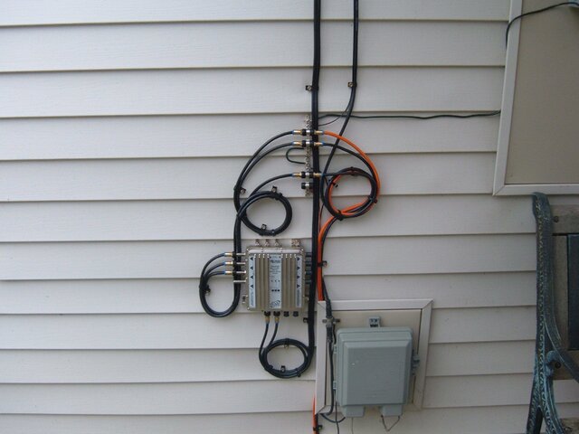

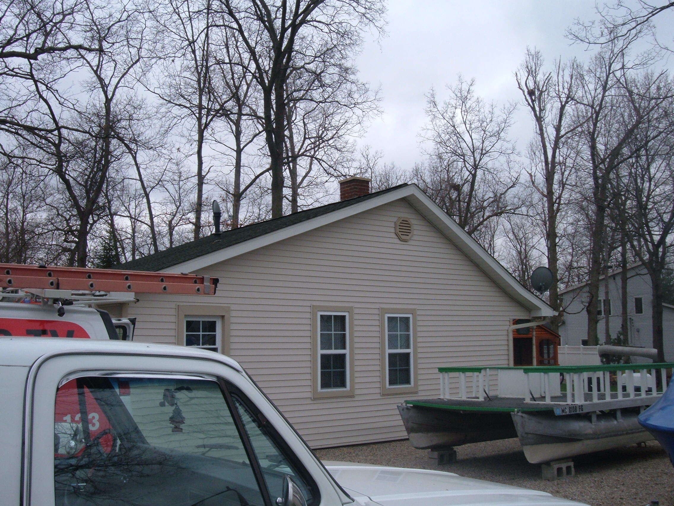

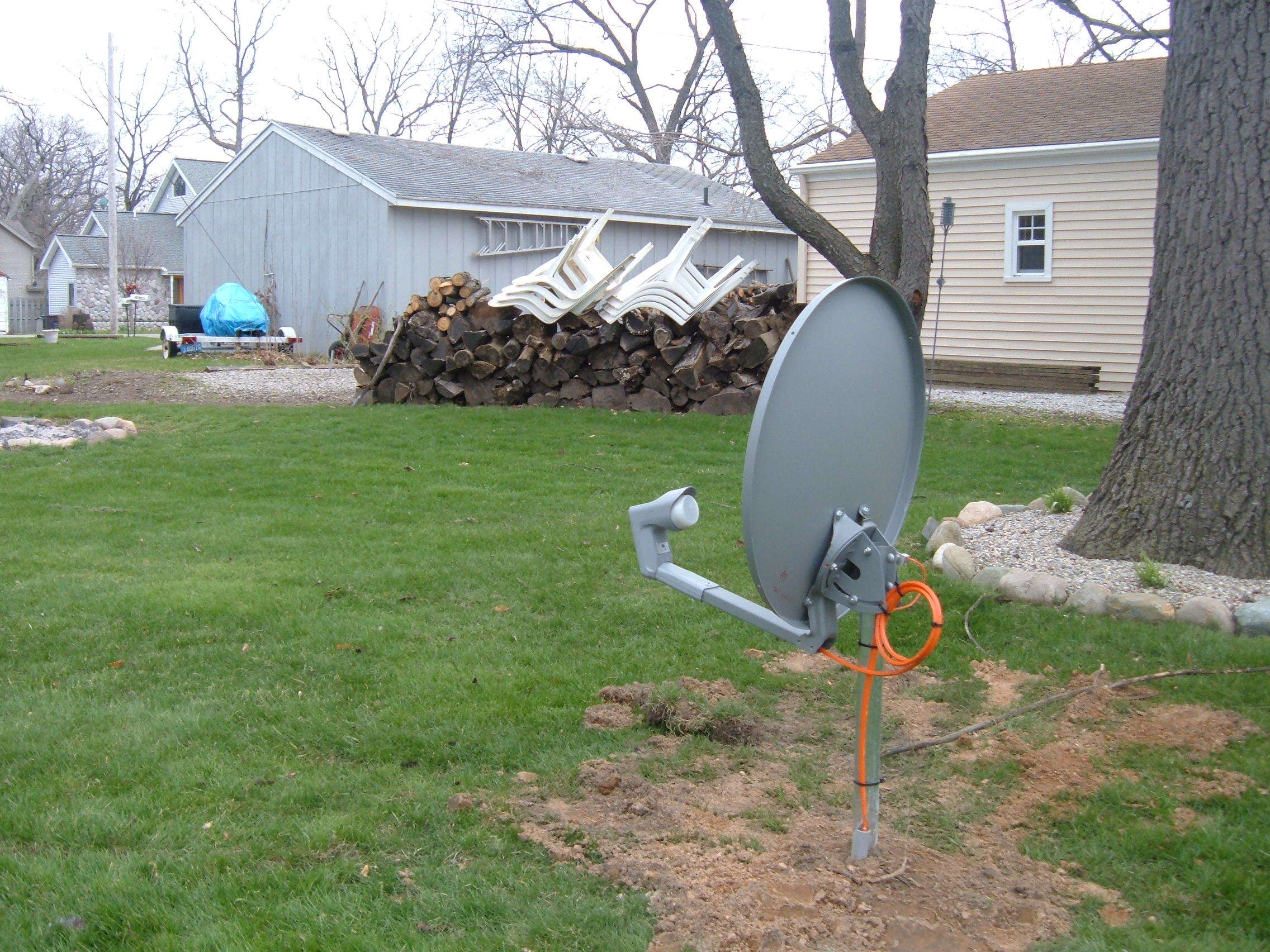

Well, just when satellite installs started to get boring, I finally got to do a install that tested my edurance and skill as a DISH installer.
Here's the scoop, about 6 weeks ago, I roll on a New Connect, 3 room install, 211/622 - 119/110/129 orbital out in the backwoods surrounded by tree cover, as I turn onto the street I start thinking yeah right.
Customer currently has/had DirectTV dish so there must be some hope, so I go onto the roof with my Suunto, checking for LOS to the 110/119, it looks ok, so I then obviously seeing I can't get the 129, so I look for the 61.5, looks like I have the option of putting 61.5 kitty corner of the roof. Cake install - add a wing dish right? Nope.
As I start to unload the van, right as I'm about to start installing the mast for the 110/119, I figured I should double check for LOS before I do any drilling, sure enough my LOS for the 119 looks like it would only last until the trees filled in, so I ruled it out.
I could not get LOS for a Dish 500 on 110/119 on one single dish. So I end up spending 1.5 hours going over the customer's entire property, seeing what all my options where... I finally ended up finding I can get the 110 on the roof of the house, 61.5 kitty corner, 119 other side of his yard, only problem with the 119 is there's a tree branch pointed right dead smack in the middle of the path.
I talk everything over with the customer, advise him about the tree branch, and advised it would have to be a 3 dish install spread everywhere, and this type of install is strictly more or less geared for the "power user", and if I did it, it would work well, and for a very long time -- Customer reschedules, I advise him if it's not me, I'm willing to bet the next tech will laugh and call NLOS and ride off.... time goes by, I hear nothing about it.
A couple of days ago at a team meeting, indirectly I'm being bitched at if I roll onto a job, do not make promises to customers, you cancel a job if its NLOS along with a bunch of other BS. I say nothing, but I am thinking about that particular job in the back of my mind throughout the day.
Sure enough today I look at my work order, look at the notes, and its that job, I'm thinking hell yeah.... I see notes on there about the customer being upset because the last couple of techs out there said it could not be done, customer paid to have tree branch cut off, keep in mind the last tech out there is the one who's installed for years..... I'll end that there.
Anyhow, I roll onto this job this morning, enroute I change the work order for the correct equipment, I spent 30 minutes on the phone, apparently DISH does not have a way to reflect 3 dish installs, apparently noone ever does one, anyhow I line my ducks in a row and plan how I'm going to knock it out. I pull up, get out and check my position for the pole on the 119 in the yard, and sure enough I got it. Customer comes out, I tell them it's going in.
By golly 7.5 hours later it was finished, and I tell you what, it'll work for years upon years provided how the dishes are strategically placed for LOS. Boy where they happy they finally have High Definition, I know DirectTV could not of done it off of there fancy oval looking dish, I know comcrap sucks in that area.
All in all, it's rare where you can find LOS using single dishes on the 119/110/61.5, its usually either of the two.
110, I'm 5 degrees above tree line, 119 I am 5 degrees below tree branches, about 5 feet to the left of the tree trunk, and 61.5 I'm smokin wide open about 12 degrees above.trees period at that I don't see the aging trees growing much more anyhow, there already tall as can be, plus at the distance back I am, I estimate about 15-20' above @ 110 location. The 119 dish is about 60' from the house.

And they allowed you to use a DPP 44....with no b*tching or moaning from Dish? Ok. Curious....how did you manage that one?
BTW...nice use of the underground (orange) rated coax :)
EDIT: hahahaha...just noticed the cable company's groundblock...going freaking vertical!!!
I had to do the same kind of thing once. VERY tight LOS on everything - 119,110 and 129. I had one hole in the trees. Pretty good size hole, but not enough to fit a single dish solution into. Talked with the customer and ended up setting up three poles several feet away from each other in a row. One for each bird. Used a DP Dual on each one and put them together with a 34 switch. Thankfully he was only hooking up two rooms, so I only had to run a single line of double strand wire to the house. If more techs looked for ways to get things done instead of how NOT to do them, DISH would have a larger customer base.

Nice job, but why do they make you use that god awful orange coax? Is that local code or something? I am sure it is flooded, and I know it is to prevent someone from digging it up, but I have only seen orange cable on underground utilities from ped to ped or vault to vault, not visible on the premise.
I hope you get paid by the hour, you earned it.
I was wondering the same thing about the orange cable.
Dish requires the use of flooded burial and if an installer doesnt use it then it is a negative mark on a job check.

YOU are the kind of installer/service tech I dream about. For any kind of service, satellite, electrical, plumbing...take your time, explain things to me, do it right but don't bulls%#t me. I may not know everything there is to know about installation but my BS detector is finely tuned. I don't mind paying extra for extra labor as long as it's done right. Hell, I'll even help if you need 3 hands.
Flooded cable also comes in black. The question is, why orange?
Not sure, maybe for visibility to both more easily verify that the correct coax was used and for anyone doing lawn care and any kind of landscaping or having to dig up the ground but to me what ever the color its not appealing to see it at all.
Definitely it is a clean install for the most part though I would have put the ground blocks lower and closer to the switch but all that aside unless he charged the customer for the third dish and for any line trenching over 50ft and for the labour over the amount of time that job dictated then he is costing the company money and dish is now all about squeezing as much blood out of its techs as they can.
Thank you all for the replies. I asked quality assurance to go out there the moment I left the property, to see what he thinks. It's a good thing, I seemed to have really pissed a Senior Lead Tech off because I did a job that I knew could be done. Looks like that person didn't do their job instead found a way to get out of it. It's not a NLOS, it's a 3 dish install install. The customer knew exactly what they were getting, and had plenty of time to think about it.
Orange direct burial is what we have at our office. Technically it's required.
