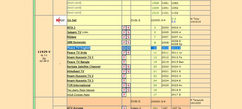

3971 is for the language pid that is what it says on lyngsat. Symbol rate means how much data they are sending bigger the SR more channels they can have its like having bigger bandwidth to use. They can't have a lot of channels on a small SR because it would be trying to fit a 10lb ham into a 5lb bag.
IDK, on Lyngsat it's listed as this, shown in picture...
