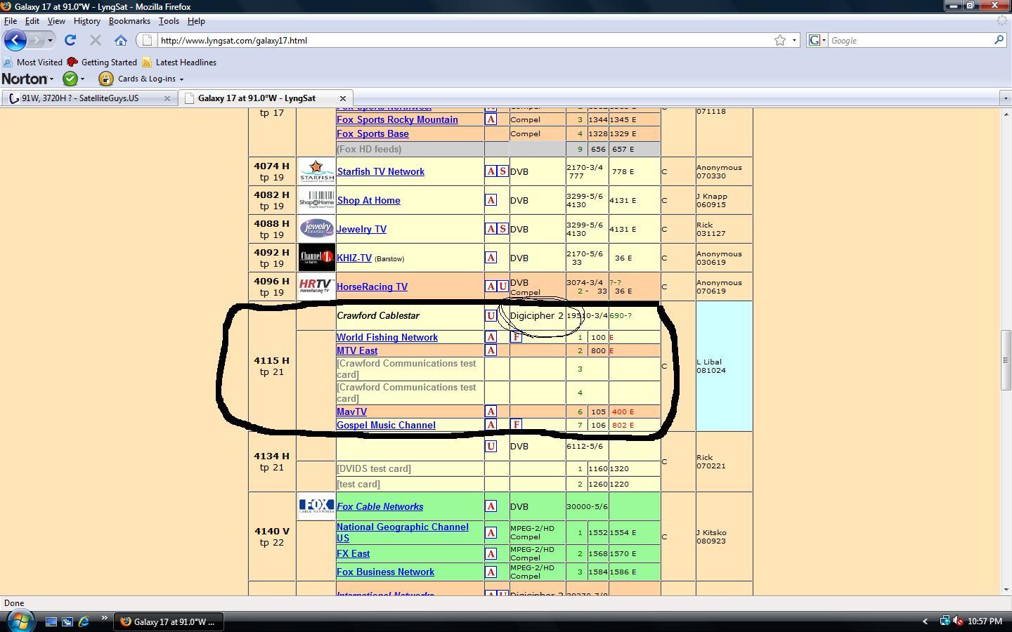

not unless you have a 4DTV...those channels are Digicipher II (DCII) so a DVB box (Coolsat, Pansat, Traxis, etc) wont pick them up
see attached from Lyngsat
the pencilled circle shows it being DCII (whereas the channels above are DVB which your box WILL get)
