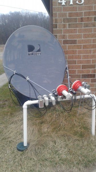

Look at my setup for example. I live in an apartment complex from hell that HATES me with a satellite dish. So thats why i have to watch what i do.

The HoJo (Howard Johnson hotel) has an old 8-foot dish. I should ask if they want to sell it, because obviously it's not used anymore (they have a DirecTV micro headend now). I may just try a C-band LNB on the 90cm dish. It can't hurt, the LNB and scalar from my main satellite shop is about $30. Not a huge waste of money if it doesn't work.
The HoJo dish is likely a good commercial quality set-up. If it is a fixed (non-motorized) I probably wouldn't pick it for your first and primary dish. Most hotel dishes are a fixed mount fixed on a single satellite. Not easily changed to a polar mount. Take a few photos and we could provide feedback and suggestions. Now that you are looking, you probably will see BUDs peaking out from behind houses and on many businesses.
