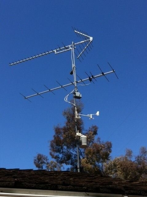

I cannot recall the models of the antenna or the combiner. Here's a pic of my setup for OTA. I have dedicated UHF and VHF antennas going to a combiner that was recommended here several years ago. No pre-amp do to concerns for overloading. I am using a distribution amp to feed a couple of OTA tuner's.

Your UHF antenna is a Radio Shack U-120 that has not been assembled correctly. The reflector should be right behind the dipole, moved to the left about two feet. The double boom and mast mount should be behind the reflector on the right side.
It sound like it has served you well for years, so probably not worth the time to change it now, however you would likely see a signal improvement on fringe channels if it were corrected.

Good eye, thank you! This antenna was a Craigslist find and no docs were available. Looking at it now I can see the distance of the reflector is to far away from the dipole to do its job. I always wondered about the support bracket not being perpendicular. :)
I will fix it with the hope that the improvement will help me with the terrible co-channel interference challenges of the San Diego area.
