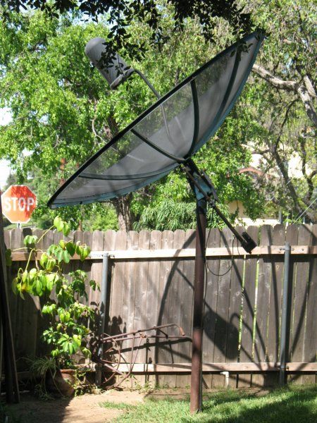

Hi, recently moved to Highland CA & left behind by owners was this big dish. Previous owners said they used to get programming on it back in the 90's. What is it & is this good enough to get reception these days?
No receivers were part of the deal, so what stuff do I need to get it going?

Looks to be in great shape. A new digital LNB and receiver, and you may be good to go. I suppose there is no motor drive box? With a minimal cost, you could have it back in operation in no time. :) Lucky you. It's most likely still on track, which is good. It doesn't look to have been abused, but a few more pictures would help.

Yes besides a new LNBF and receiver you will need something to move the dish. Something like a vbox or a Titanium ASC1.

Strange! I did not see picture in the first post. Perhaps problem of browser. Nice dish! Unfortunately it will perform good in C-band only.

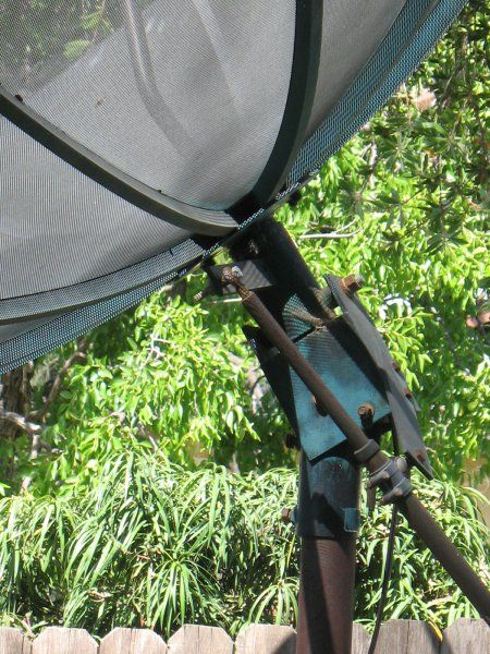

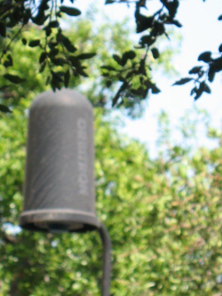

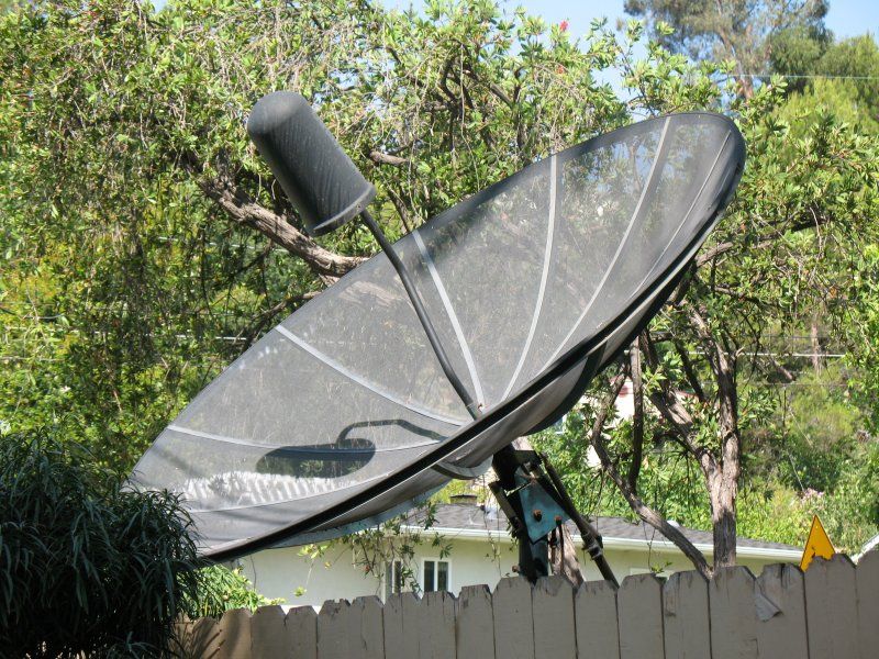

More pics.....notice name on cone.....Orbitron. Now to find out more about this model. Will have to see what's under the cone too I suppose. I have some experience with Ku dishes from a few years back. A friend mentioned getting a copy of 'the satellite bible'.

4 screws that looked to have been there since 20 plus years ago held cone to plastic base with no gaps so I didn't think any bees or wasps had made a home inside.

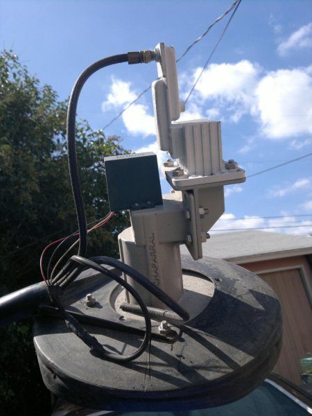

That cone was on there so tight I had to remove the whole buttonhook thing. Marked the tube depth with some masking tape first. Took it over to my friend for help deciding what to do. He has some years experience and a few dishes including a C-band in his yard. We persuaded the cone to separate from the flat plastic piece with a cotter pin puller, walking it around until lip of cone was cleared.
Friend tells me that the 'feedhorn', a fixed Chaparral one, will be fine. Just need a better 'lnb' for today's digital reception. He said he may have a spare & some better coaxial cable for the job. 2017-09-22-588.jpg 'lnb' that's on there now is a '35K Gardiner'.

Over the weekend my friend and I replaced the coaxial cables with some twin stuff he had, spliced the 'servo' control wiring, changed the 'lnb' to a 17 degree K one then set up 5 satellite positions on the General Instruments 450. Scanned in a few things with that Coolsat too. Will need to do some tree trimming to get more satellites. He showed me an app for his iPhone for checking satellite arc - neat stuff that!
After some reading, found out this is a "Spinclination" Orbitron S-8.5 model. And, fortunately, the 'declination' tape is still intact on the mount tube that receives the dish offset angle tube. Still reading up on newer receivers to choose from. Long list.
Will be doing some yard cleanup and maybe even some tree trimming today to clear up a path for more satellite reception. Loaded Kvasha satellite on my old 4S iPhone for checking this out. There's got to be a way to limit the satellites that are updated as there are a lot of European and Asian satellites in the data that I cannot 'see' from Highland California USA.
Cleaned up trees in path of dish and now have an arc of from 77 w to 133 w satellites. My friend donated to me a Linkbox 8000 receiver that had had a board level failure. We repaired it after doing some extensive searching of forums. Did a factory reset and loaded it with latest 'firmware' from Link-media online. Works fine so I retired the Coolsat 5000.
