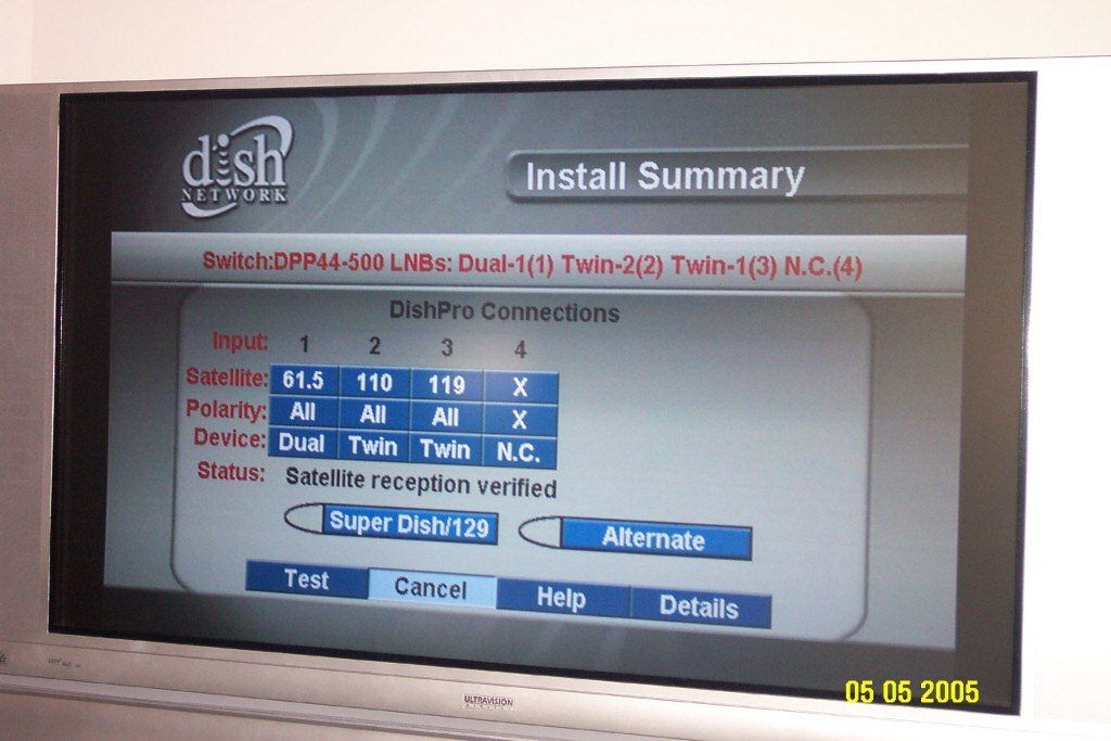

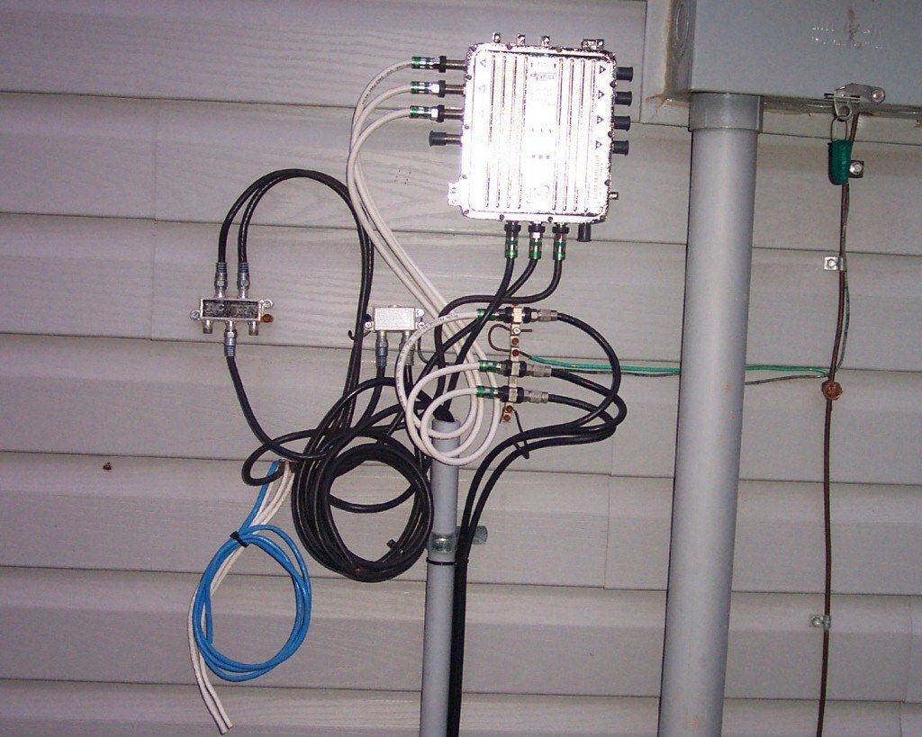

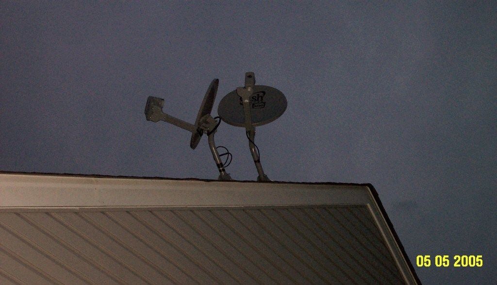

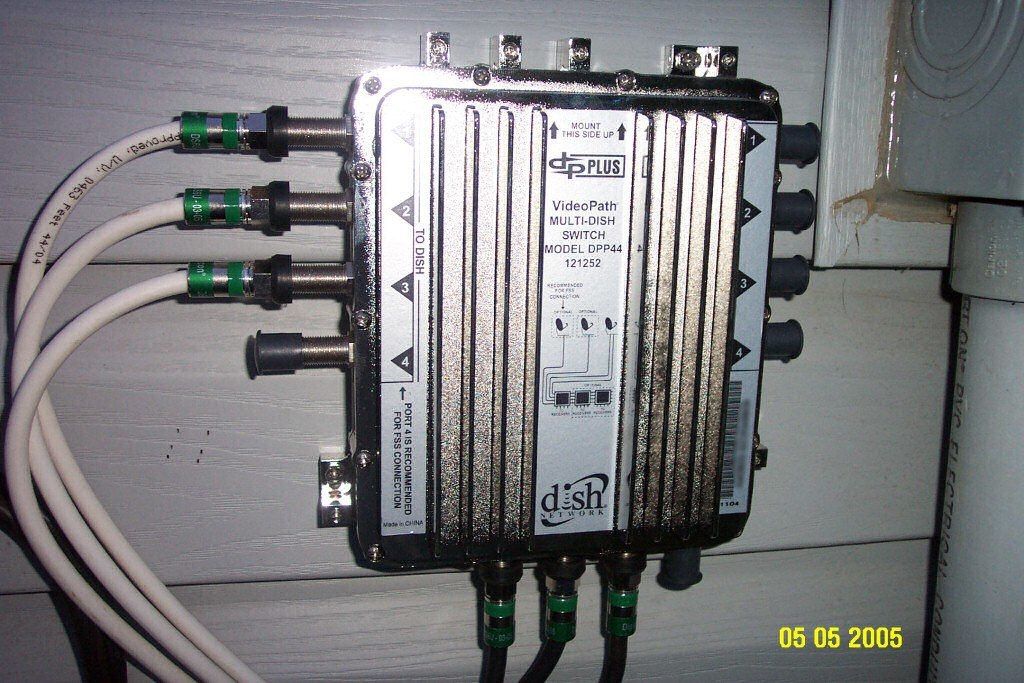

Then the shock began...he remembered the "challenges" in trying to run wire to different spots in my house, due to the strange way they ran the wires when the house was built (long story...I won't bore you). I told him that I had somewhat changed the wiring, had purchased a 311 for the garage and moved the 322 to my bedroom...and that the 322 was running with only one wire running to tuner 1, and nothing to tuner 2. (I also have and 811 for HD in the living room) I also mentioned that I planned to upgrade to a 942 in the living room someday. He said not to worry about the wiring issues...the new switch would fix that. Since I thought I had a fairly simple setup, I wasn;t expecting a big switch, but lo and behold, he whips out a DPP44! After all the talk about them not being included with the $100 install, that was the last thing I though I would see. He also replaced the Quad LNB with a new Twin (I think I got those terms right!) on the 110/119 dish, and gave me a seperator to add to the 322 in the bedroom! All told a VERY nice, clean install. Ran all the wires (see pics below) installed the power inserter in the attic where the lines come over the garageand, ran check switch on the 311, 322, and finally 811.
The 811 locked up on the first check switch...pulled the power and ran again and all was good. He called and verified the Voom package had been turned on while the 811 booted. This time the 811 ran thru the check switch w/o problems. When we first tried to tune the Voom channels, they were still red in the guide. He ran another check switch, and checked again and they came in this time...been Voomin ever since! The PQ is very impressive! He did say that he had been doing quite a few 61.5 dish installs in the Charlotte area.
