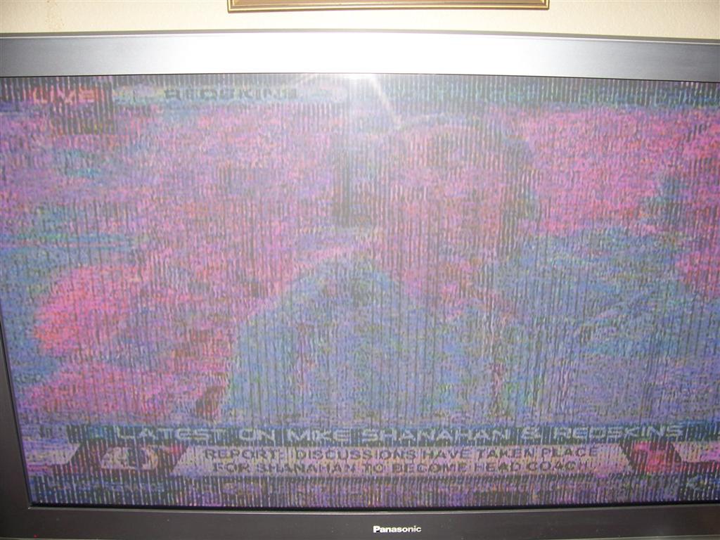

Welcome to the club. :D Only mine gets analog and digital looks like this. :(
I'd love to replace it with either a modified *choice box or a 5DTV.:p

If your screen is like what kbghdg is showing then maybe you could check the cables from the 4DTV to your tv.
Sometimes these cables can degrade the signal from the receiver to the tv.
Just something to throw at you...
