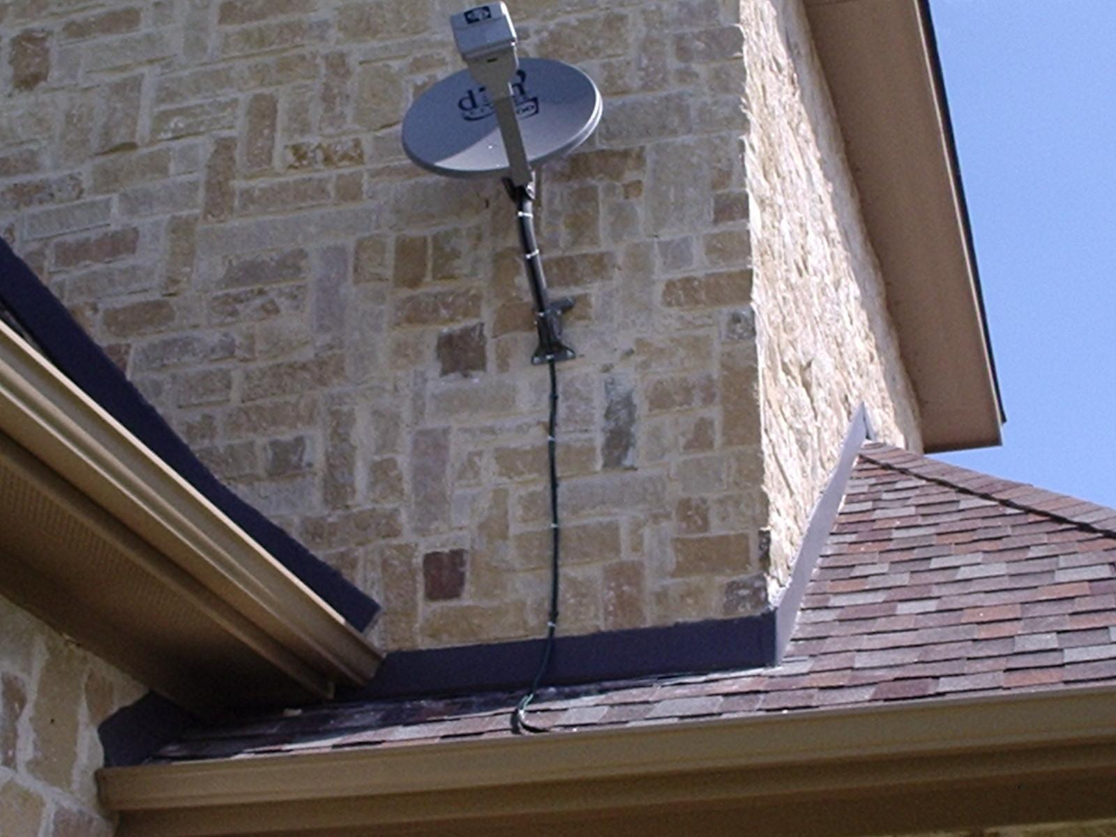

What about if you get shock from just doing the dish, I means nothing get connect yet. ONe experienced was, putting the dish attached to the wall stone, I am sure the lag screws will not pass through the stone, when you touch the dish you get shock. And touch the gutter sometime feeling shock too.
