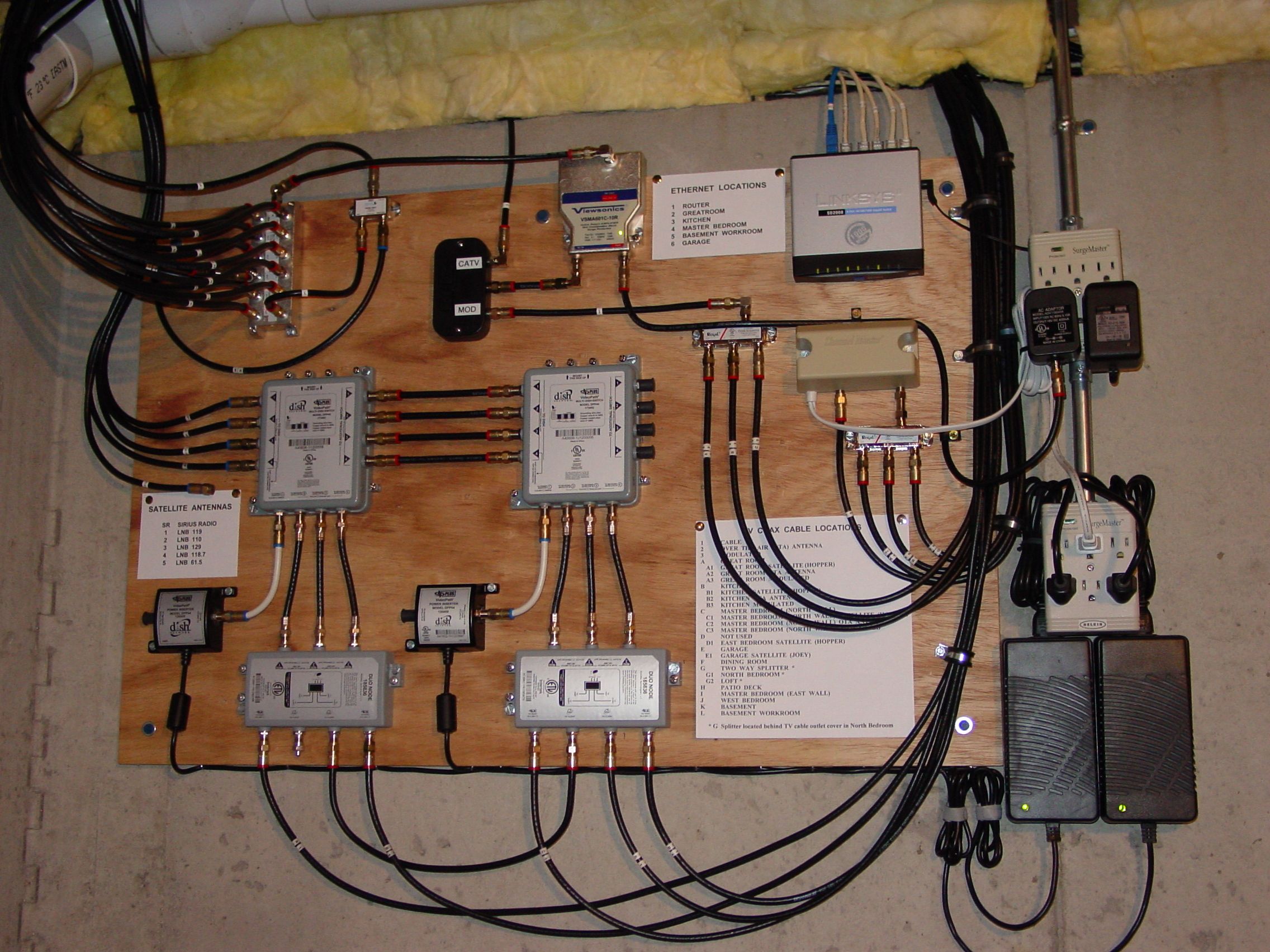

Charles,
Can you also post a photo of your installation that you're using for your avatar. I know you've posted it before, but I couldn't find it. I'm considering going for a 3 HWS 1J myself.
Thanks,
Dave

Sure, here you go. My kid has moved out so I think I am going to reduce down to three HWSs soon and also reduce down to one WJ.

Here is my system diagram for four HWSs and a Joey using DPP44 switches. I don't think you will need a Dish 1000+ dish unless you wish for international channels.
Yeah, I remember seeing your diagram before -- I figured since you used a 1000+ that 4 sats were needed! What a relief to know that a 1000.2/1000.4 will work just fine. Tx again.
