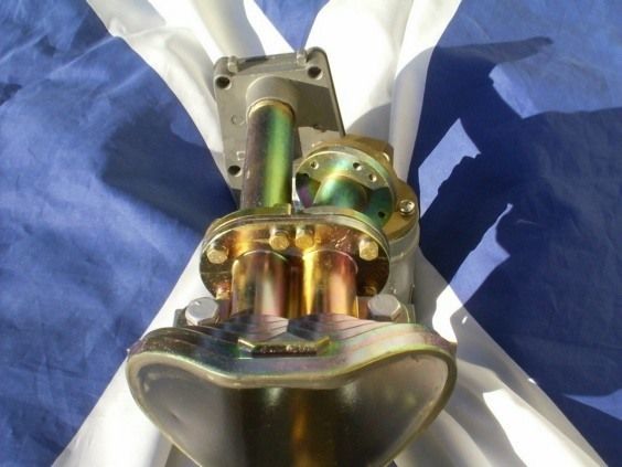

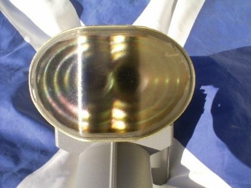

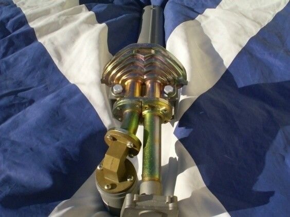

I used to use the below to get both 101 and 99w at the same time, that would be the ONLY way it would be possible!

Its from an old DirectDuo dish that I used to install for DirecPC, thats the last one I have (I think). One LNB looked at 101ºw and the other was pointing at G4R @ 99ºW

It has two 120mm flanges! So 2 LNB's can simply be bolted on! May have to file a flat on each one! No BIG deal!
