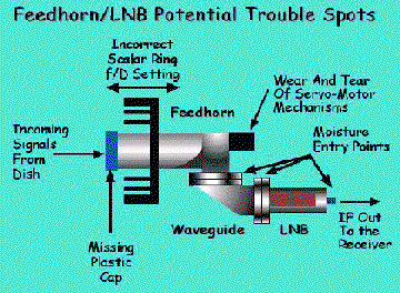

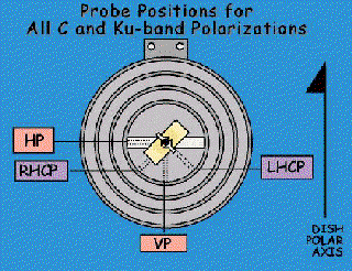

Thats the little motor inside feedhorn LNB's, by moving it the polarity changes from H to V (L to R)
