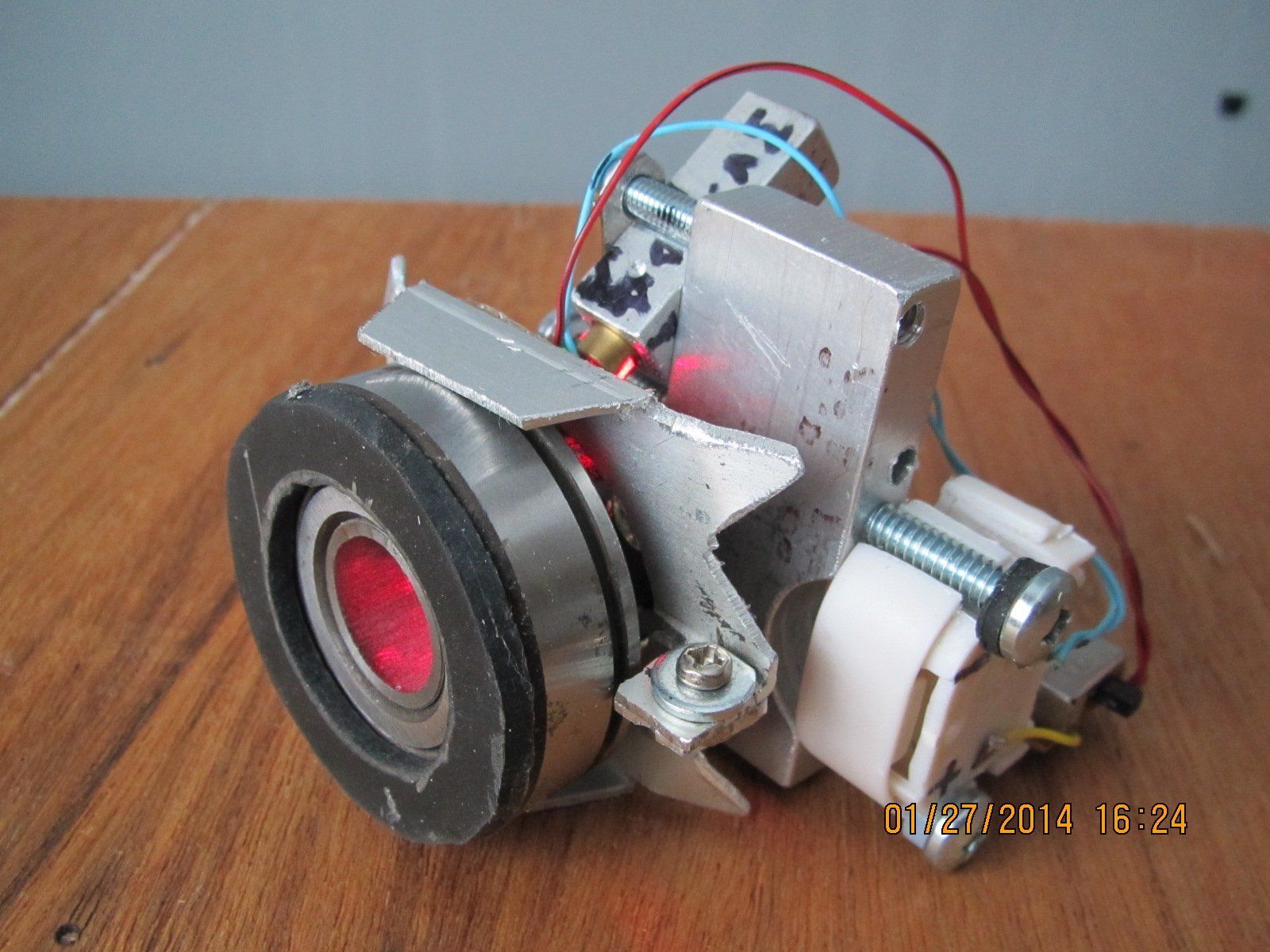

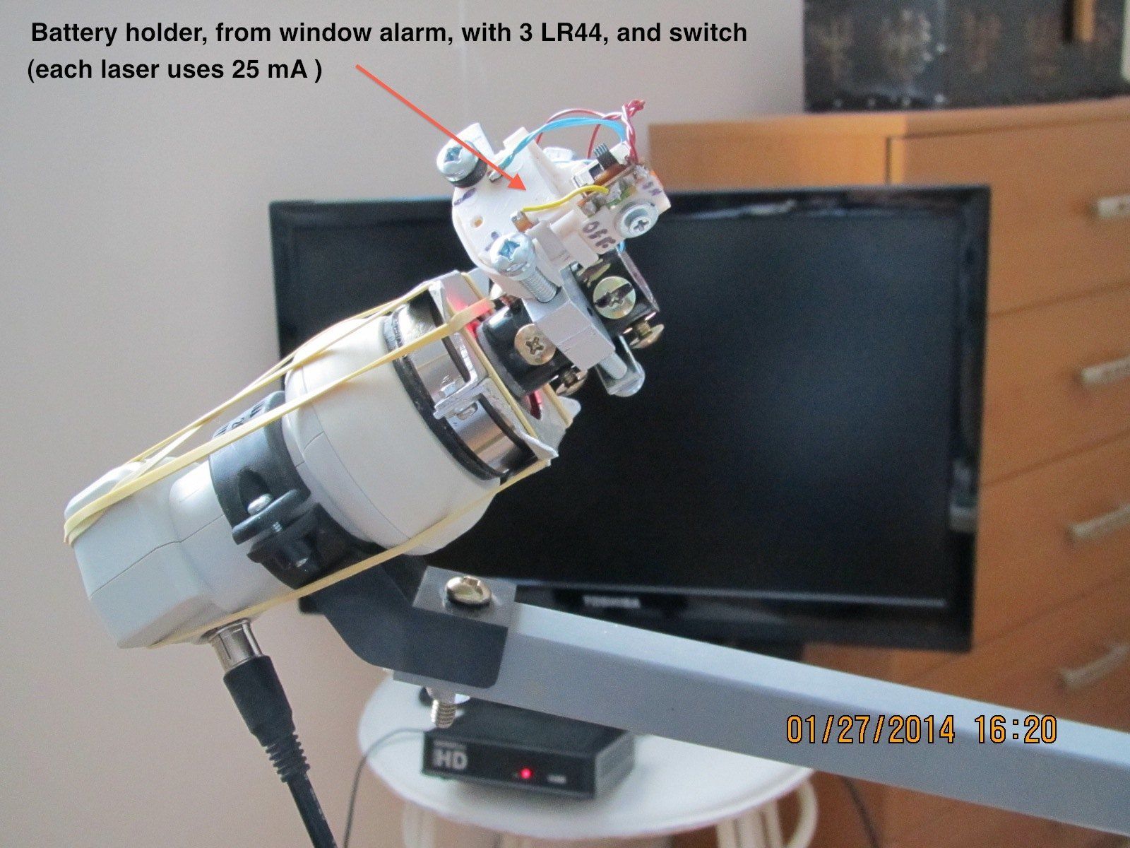

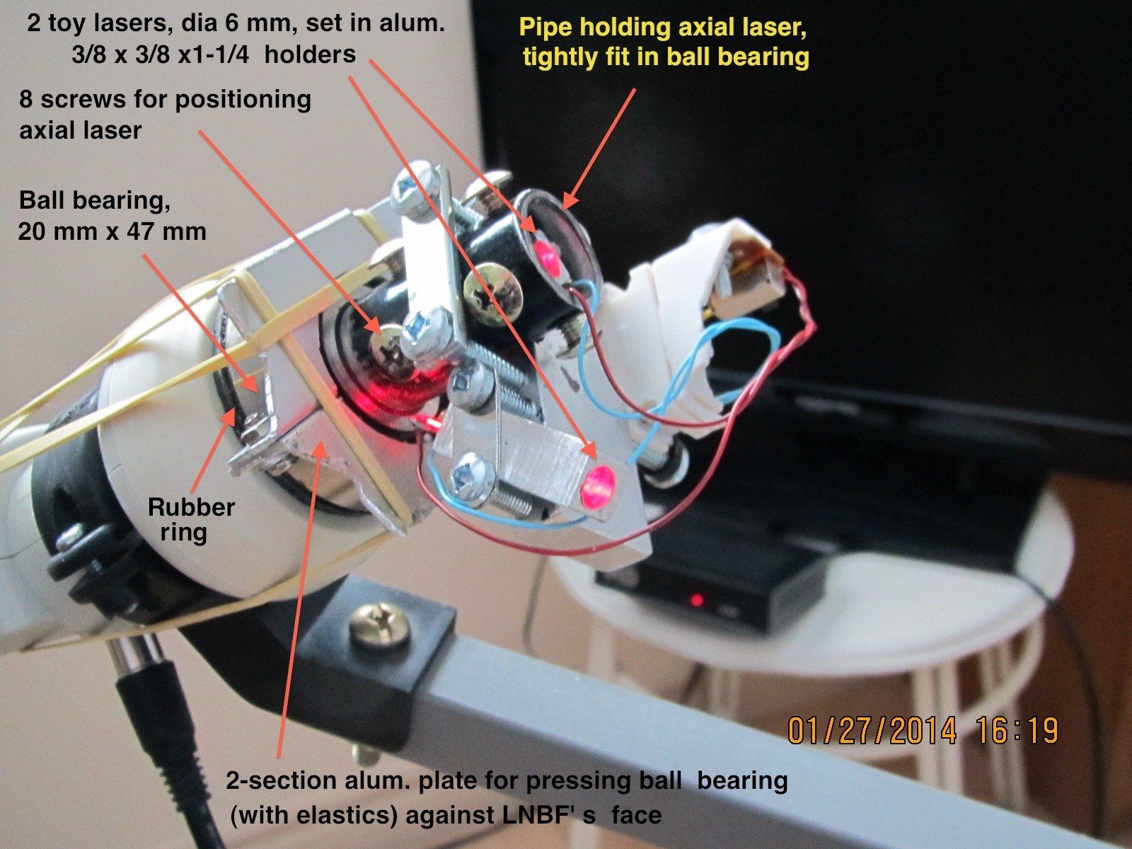

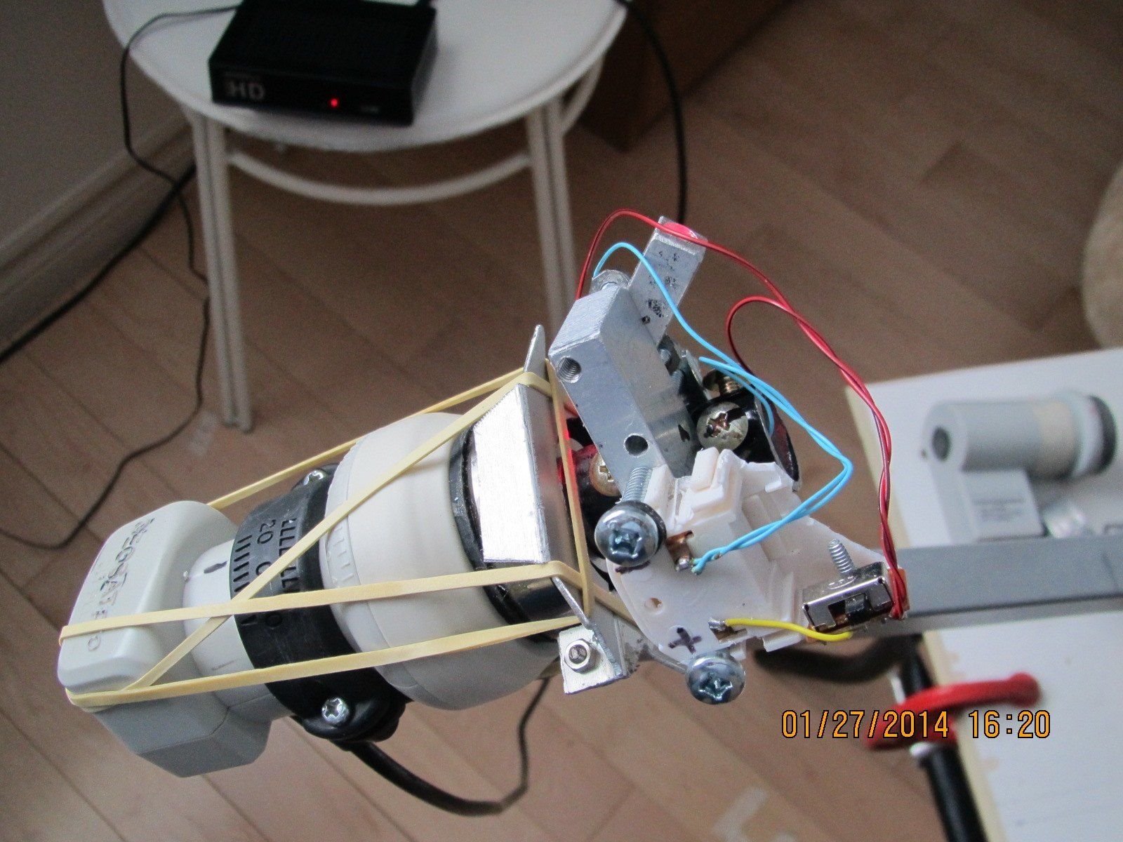

Inspiration for this jig came from our forum member, Kodaz, who suggested to Titanium that he utilize this idea. As it was for C- band, where big dishes are symmetrical, probably this would be redundant.

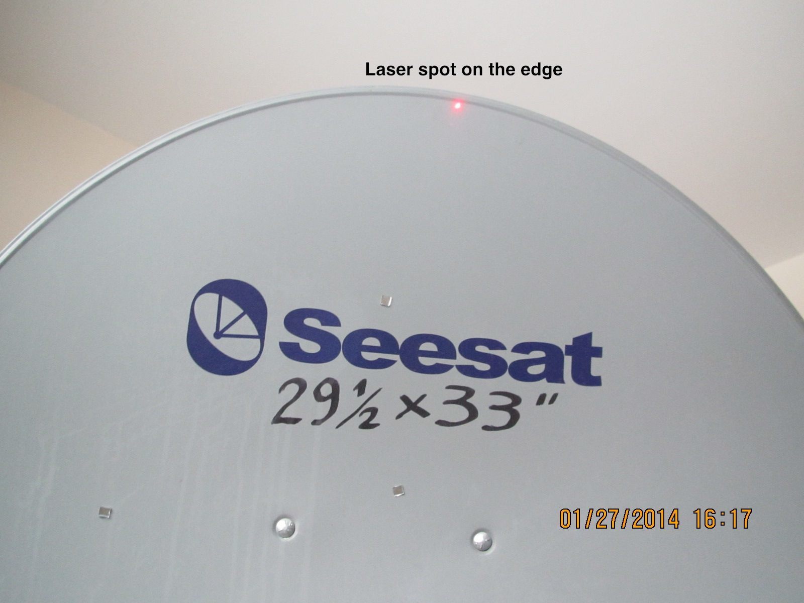

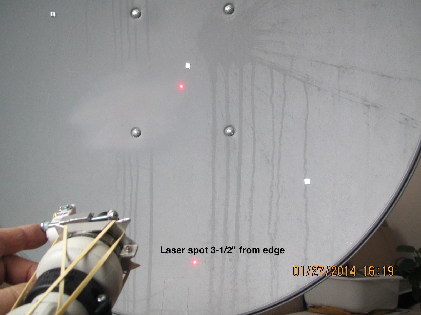

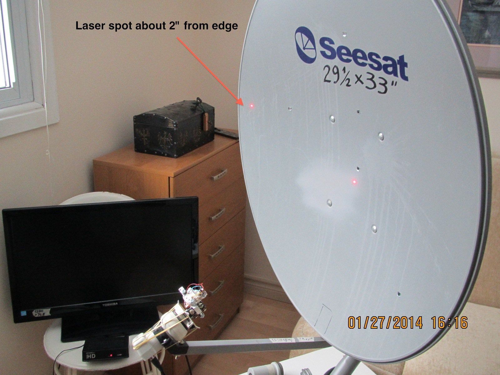

However, things are different with offset dishes, and it was always puzzling for me, what part of the dish is best illuminated by LNBF?

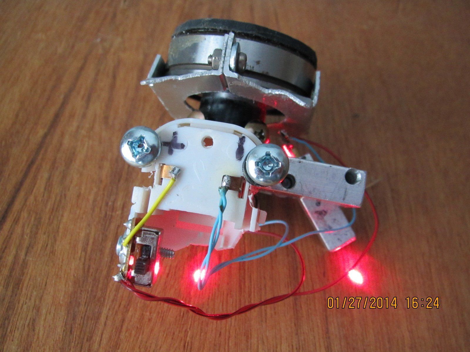

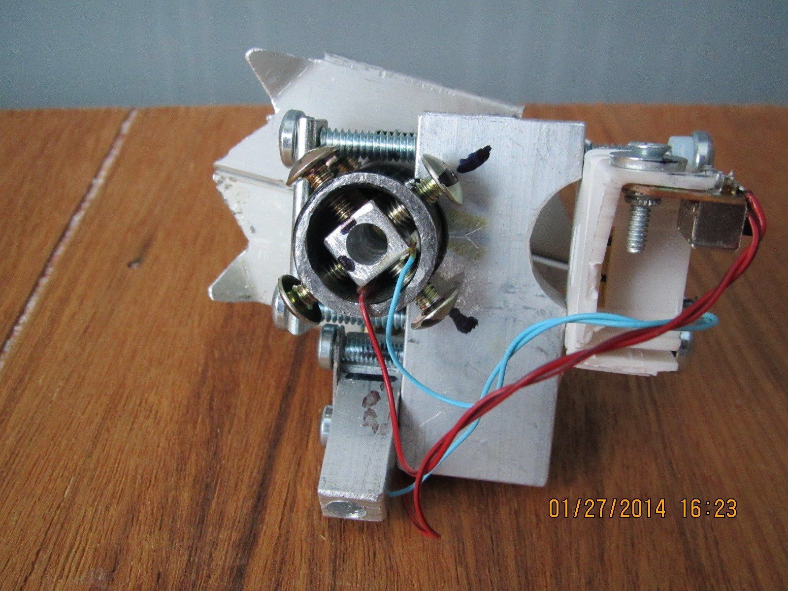

So, I built this prototype, cutting some corners, and finally got it working.
Regulation for angle laser is really poor, and the jig is not weight balanced, so it needs to be held for particular positions.

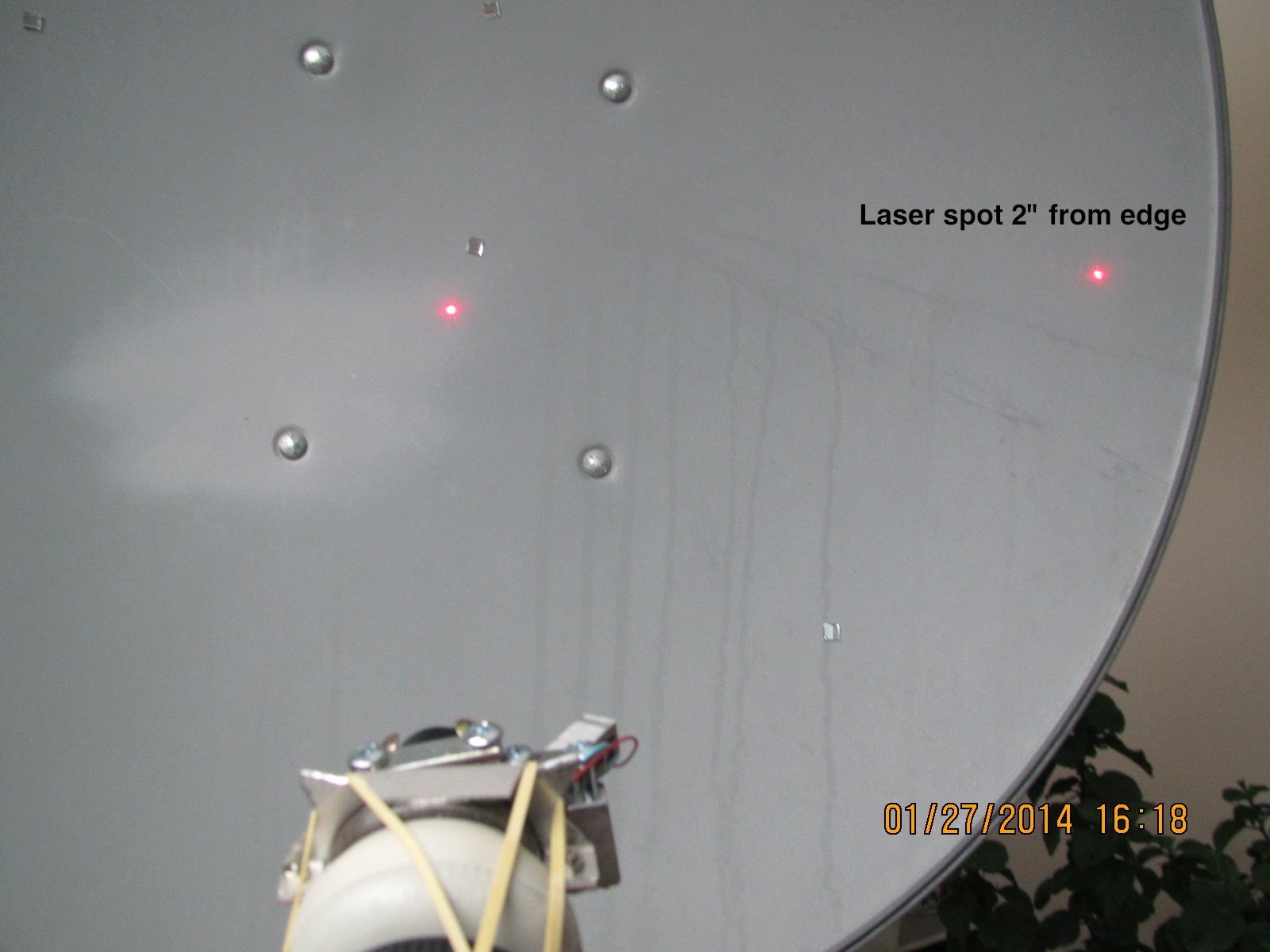

So far, I tested 2 dishes,(only one photographed) and it seems that the LNBF's are aimed too high. Could it be on purpose, to avoid thermal noise from Earth?
Waiting for warmer weather to check other, outside dishes... Cheers, polgyver

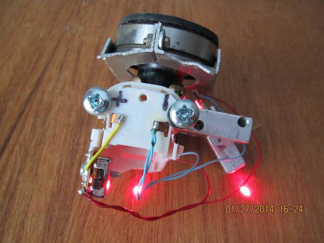

Very interesting reading from your link. Mostly about powerful green lasers. The toy lasers used in this jig take 0.025 A, at voltage 4.5 V, therefore power is in the range of 0.1 W.
Tried them with reduced voltage, 3.0 V. Current dropped to 0.009 , so, power was 0.03 W. And the beam still visible, although a little weaker.
They have internal resistor, 680 ohm.
