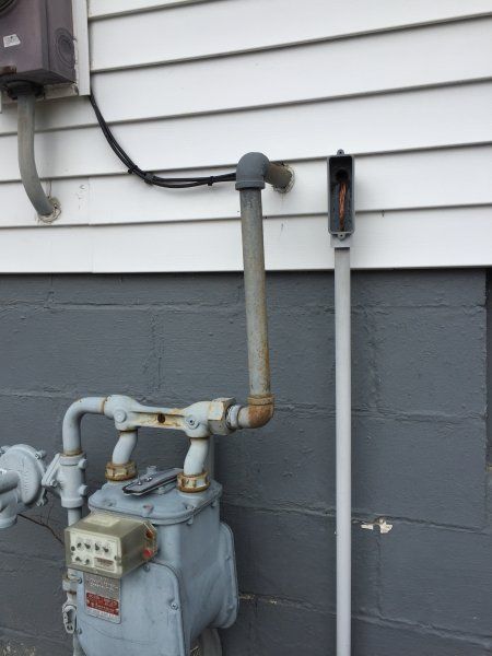

Here are the entry points at the house. Top left corner is the electrical service, The two wires running next to the service and toward the gas entry is cable and phone lines. The conduit on the right is where the house ground braid comes back out and I assume goes to ground rod. Would you attach the ground to one of these, or would you punch the ground wire through to the inside and attach to the ground braid near where the cable and phone attach to it in the electric closet?
I would attach it to the service box in the top left corner
The best way to get a ground is off the braided copper cable inside the house where it runs bare.
You should run the wire outside and ground at the point of entry, but you can ground indoors also.
The dish is not necessary to be grounded. I have never grounded a dish in over 20 years.
I usually like #10 or #12 for a ground, but remember it's just for static and to keep the grounds balanced. It's not intended to divert a lightning strike
