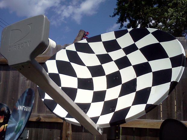

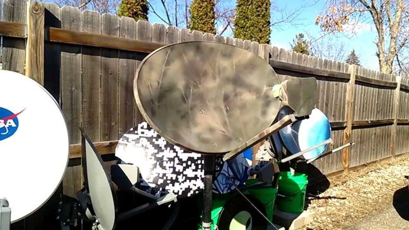

Peter has been turning out some incredible dish artwork. Take a look at some of his projects.
