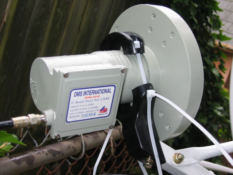

The LNB is zip-tied on for the moment, this is the strongest signal I've managed to get with my setup, nothing has been tweaked as far as the LNB/dish go, and nothing has been photoshopped.
The only thing I can say is that this chan won't lock for some reason.

If you saw how I'd attached this LNB to the arm you'd see why I'm so excited to even have a signal :)

what are yougoing to use for a LNB holder? I have a 1.2 CHannel Master and a Offset C-Band LNBF but it does not fit in the holder.
Wholeshoe
This what I've been working with up til now, it's very temporary and I'm working on brackets for a better solution.

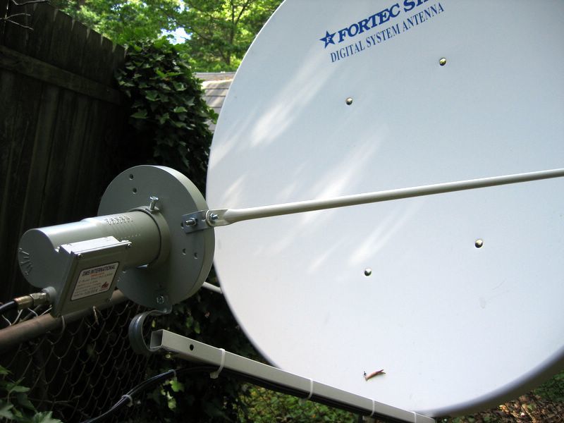

Yeah, just imagine when you get it properly mounted aligned, instead of just slapped on there! :cool:
Still not permanent although it seems to be at the focal point, or in the ballpark.
