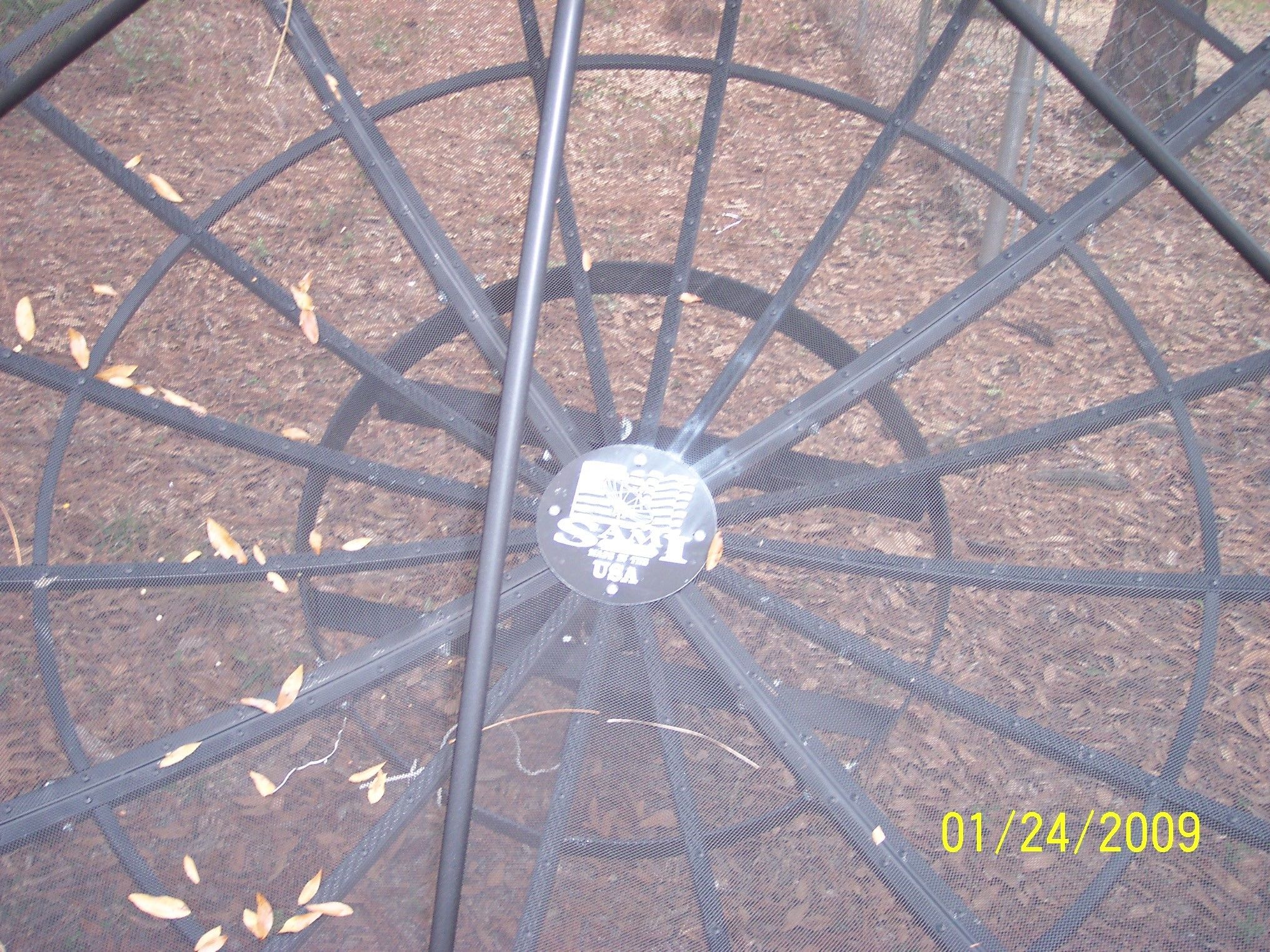

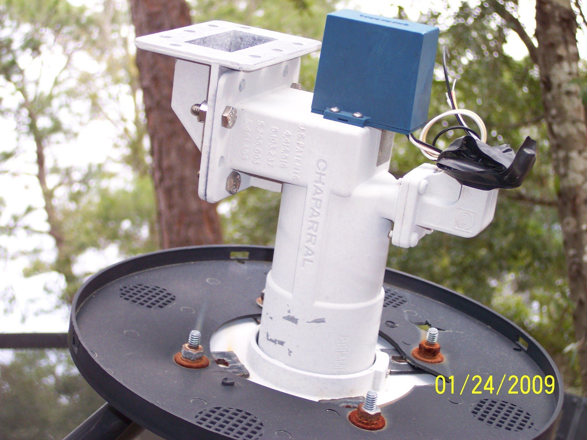

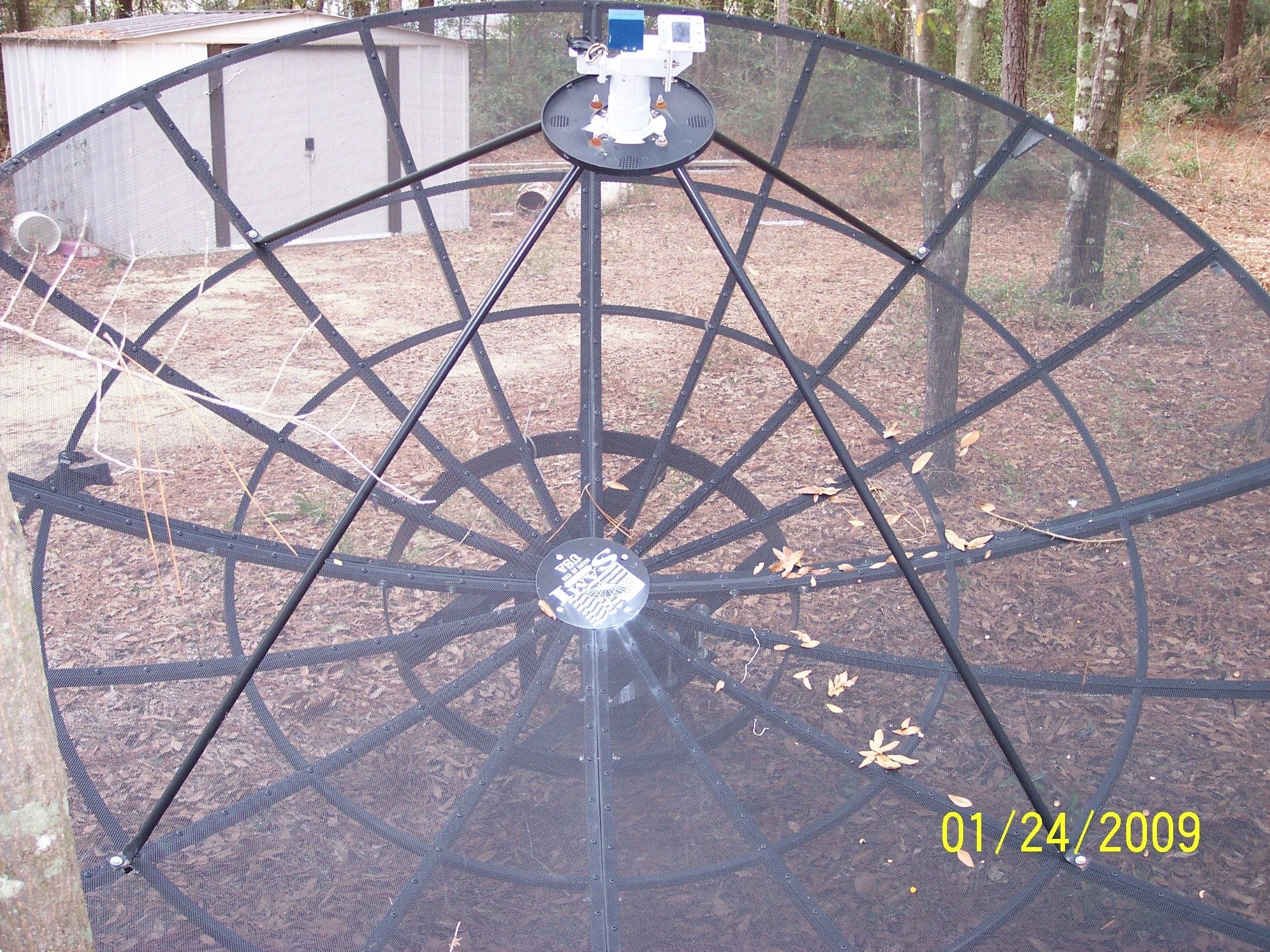

I was lucky enough to come across this 10 ft sami,A 1 meter primestar dish and 30 ft of rohn tower,the man told me to take it all, so two of my friends and I took it down.The lnb's are gone from the dish but that is no big deal,and it does not have an actuator,it came from an old radio station,so it was a fixed dish.The rohn tower had a parabolic antenna the radio station used to send out there signal,but someone took it before I could get to it,but for free I cannot complain to much.

The Sami looks really clean, no rust or need for painting! Just pop on a WR-75 flanged Ku LNB and a C-Bander, and you're good to go :) Tower segments are always useful as well, with the coming OTA DTV transition :)

Nice looking dish babcea, an very clean. now after reading this part of you're post had to get back to you on changing out you're Channel Master dish.
now you're Sami looks like it has a 36" ring which makes a dish more ridged, now most of the CM dishes came with a 24" ring, an some had a 32" back frame ring, I have 1 of each. an that Sami is a better built dish by far due to the larger back frame ring an the extra support ring that is welded in the reflector pannels.
but if you are looking for a gain factor you're 10-ft CM will produce more signal than a Sami will. providing that the CM is well tuned an the reflector is in great shape. back in the day when I used to tune dishes in for a living, the CM dishes always produced more signal than an other mess dish out their, execpt for a Cosmo (12-ft models never tune a 10-ft Cosmo) that was only mess that had beat CM on the IF-sniffer. an I have tuned about every model that their was made. now don't get me wrong a Sami is a great dish, but all dishes same size for size are not equal in DB gain, some will produce more gain than another from a different manufactor.
