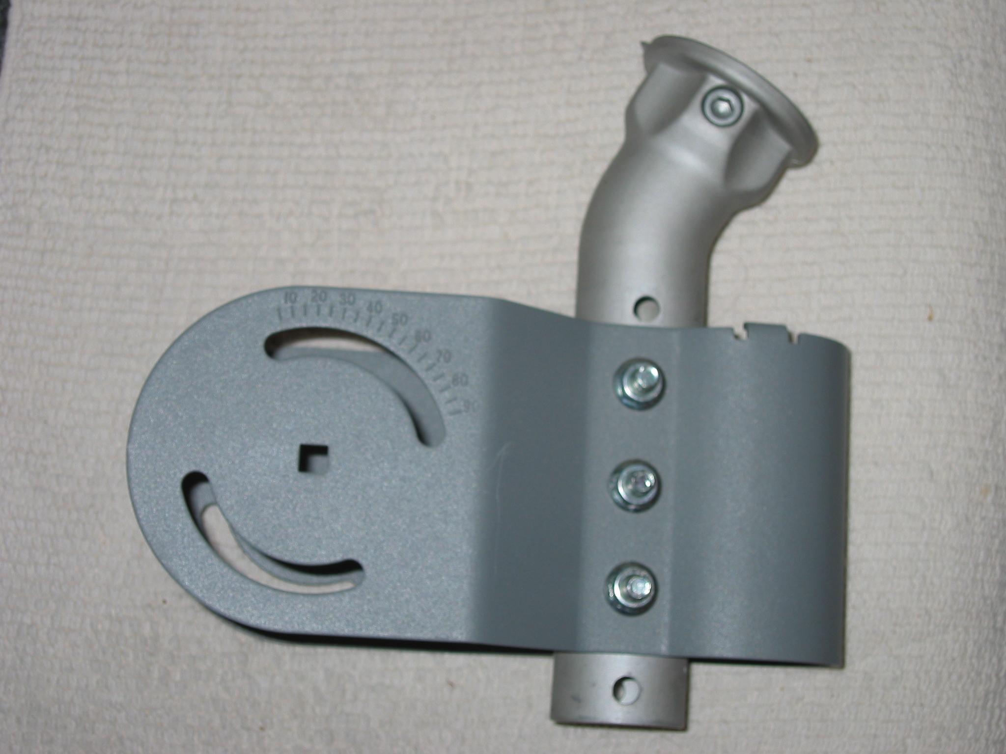

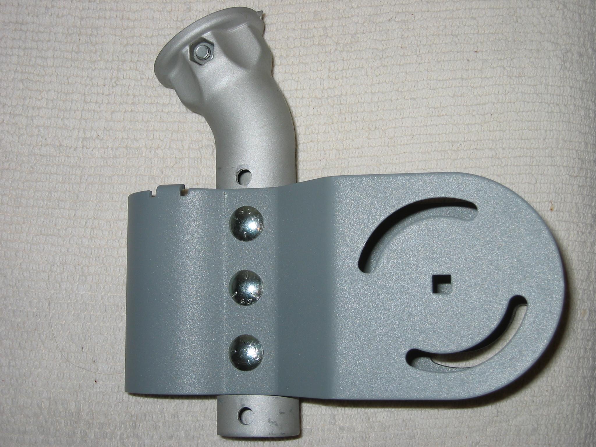

Just thought i would share on how i did my SG2100 + Winegard 1m dish. Is the same drilling idea from Here
but I drilled mine higher for better grip and support. IMO opinion this technic is stronger and more secured then the PCV deal.
