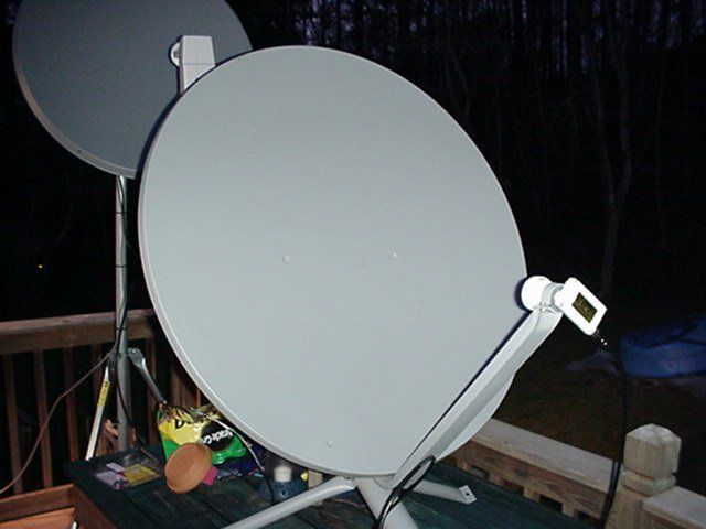

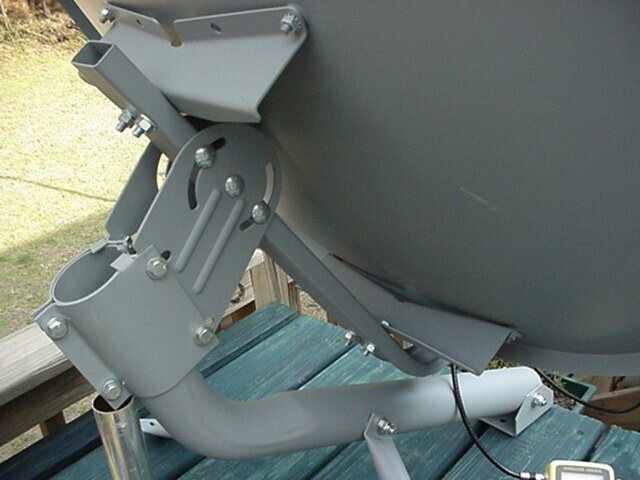

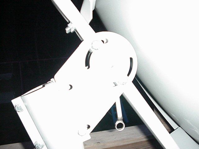

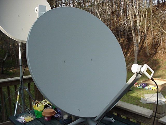

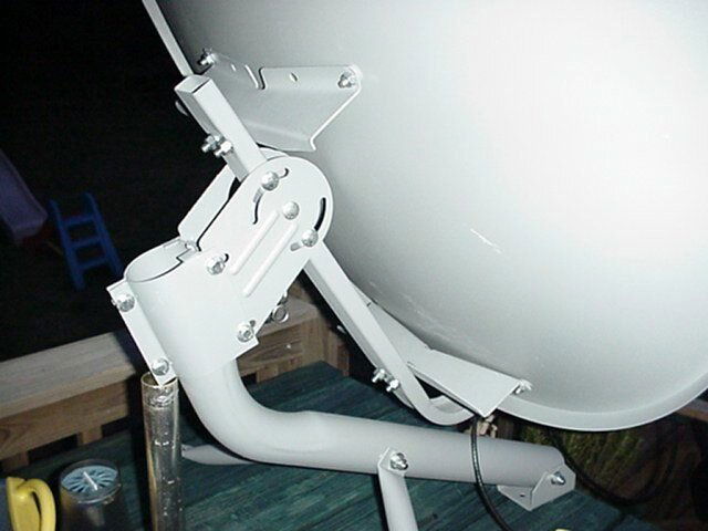

I played around with the new 1 meter dish today.I got AMC 9 rather quickly.I have never been able to get it in the past.
I took some pics of the dish.Can anyone identify the manufacturer of this dish by my pictures ?

Iceberg

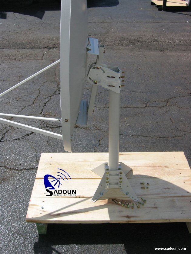

This is definitely not a Fortec Dish.

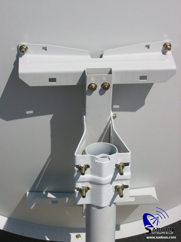

Here is a Fortec 1m dish
