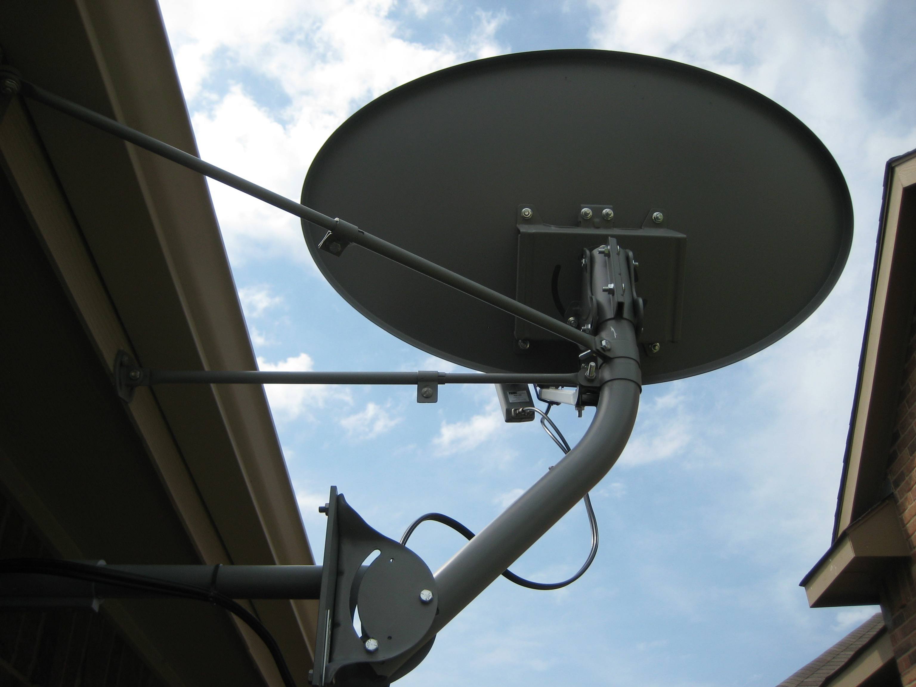

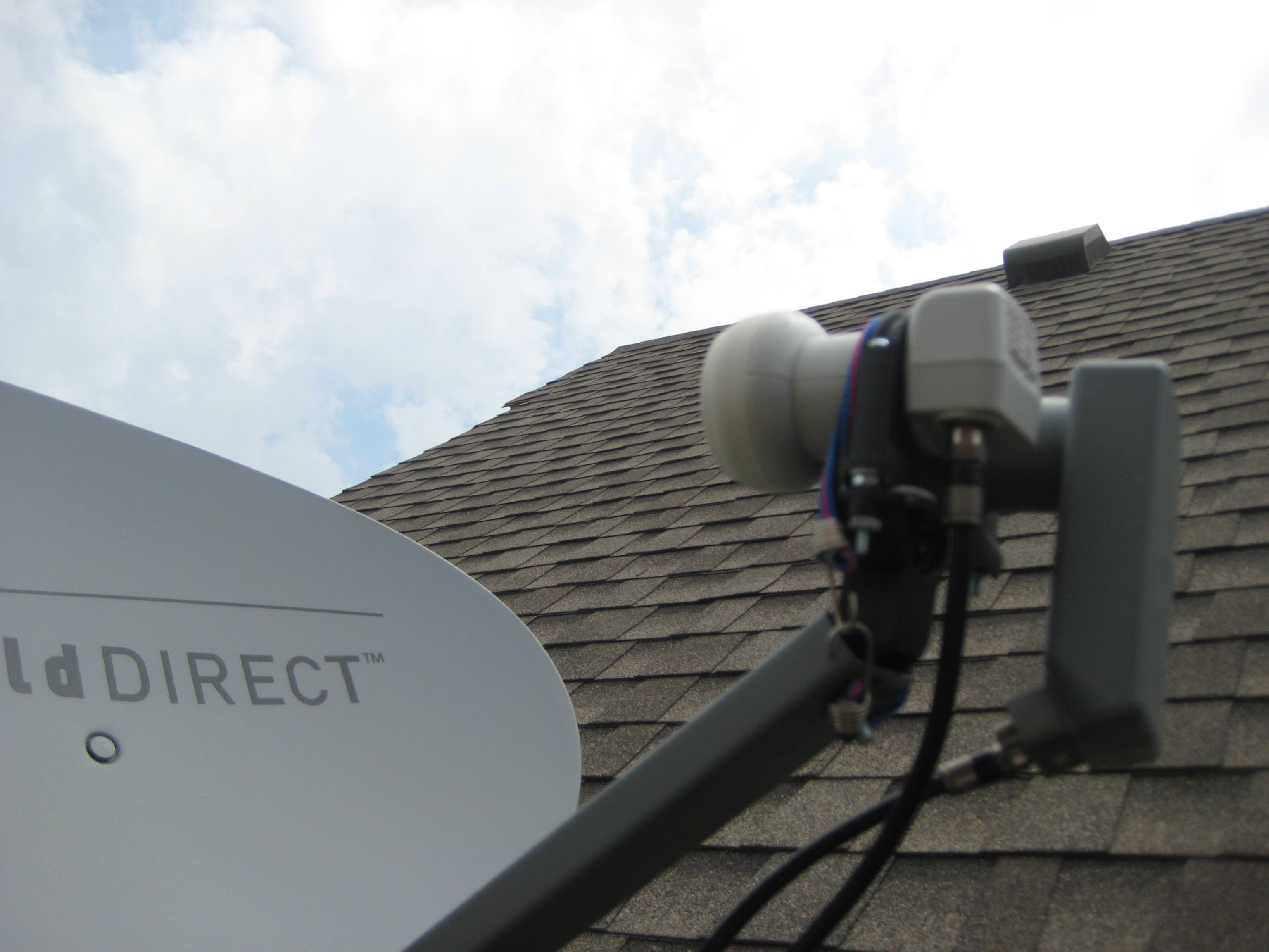

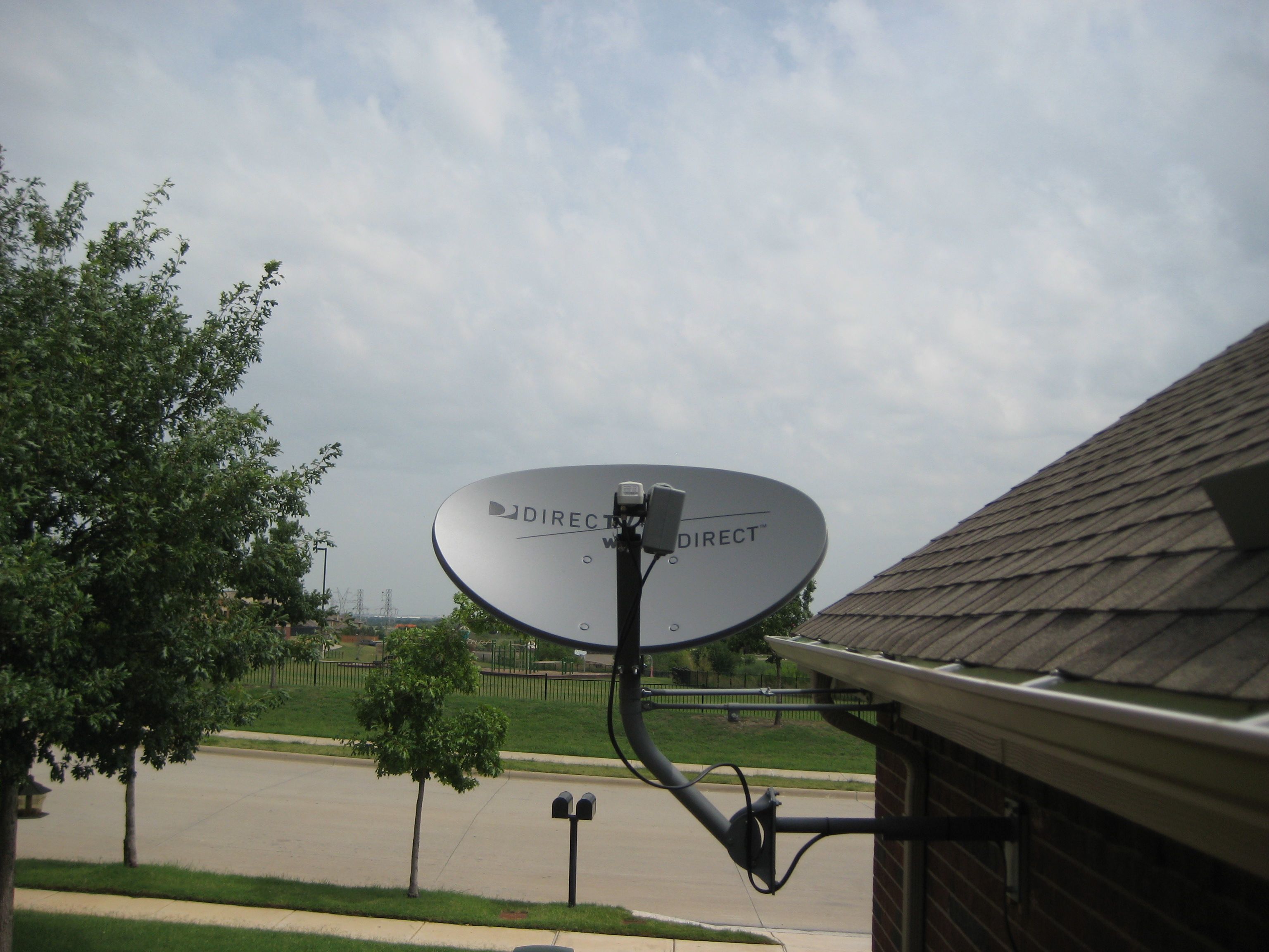

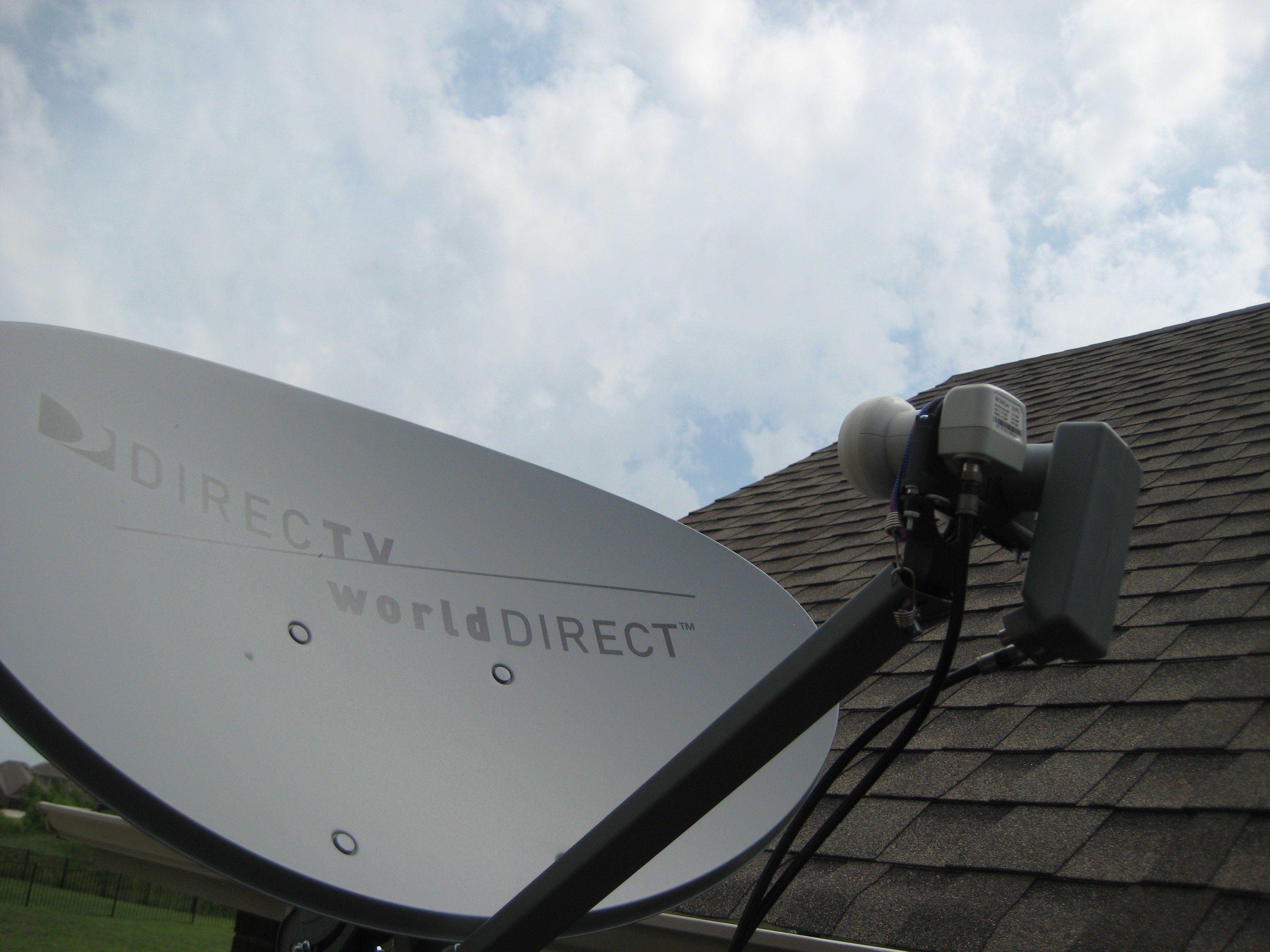

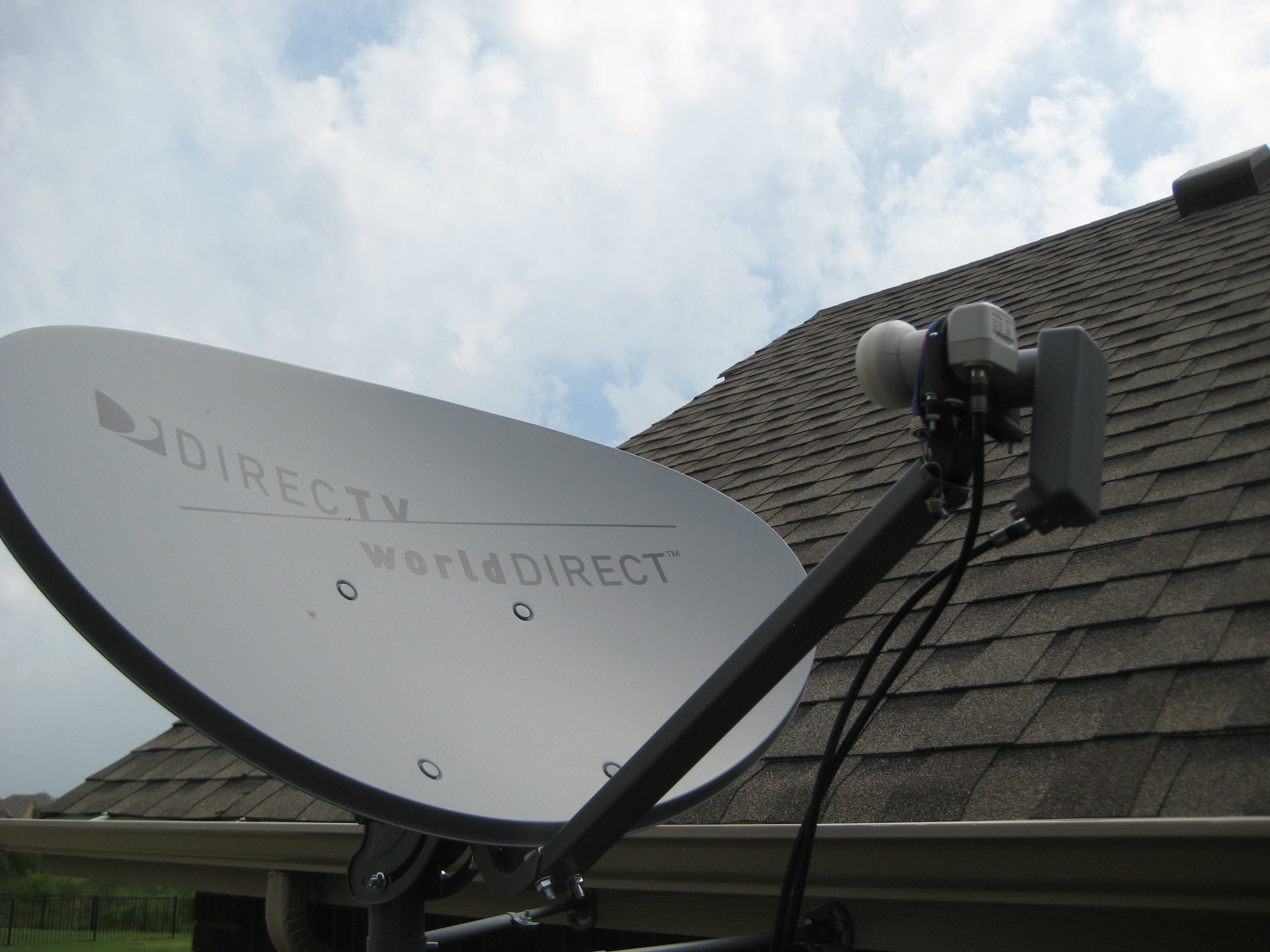

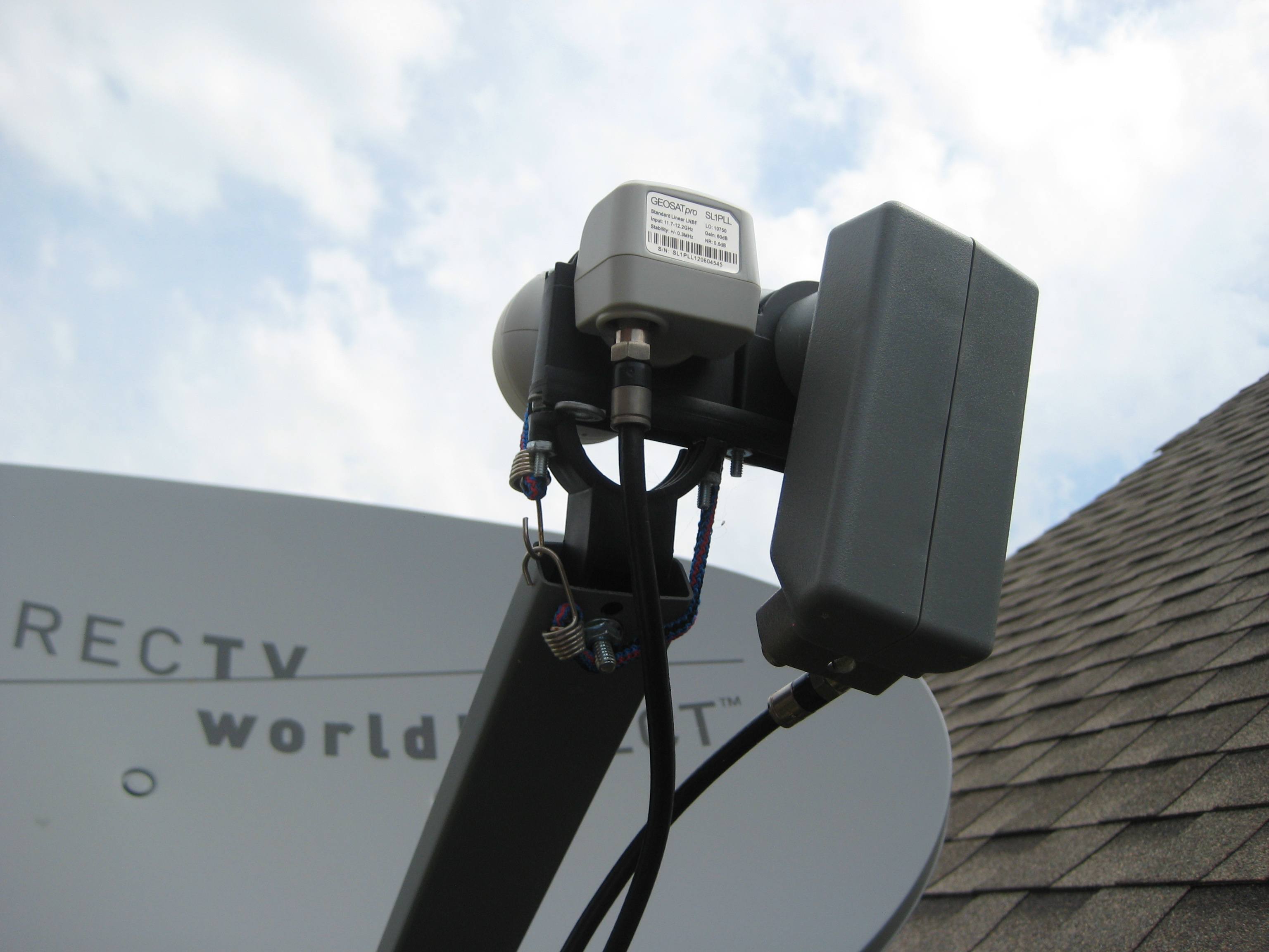

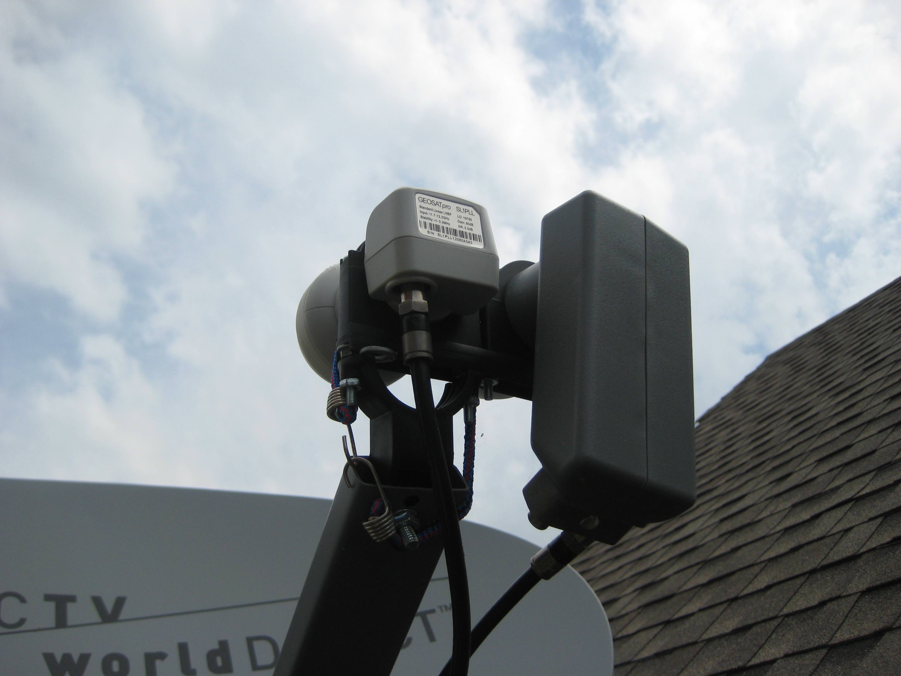

I must be lucky! Today I did a blind scan on my Traxis DBS 6000HD receiver and now I am receiving TV channels on both Galaxy 16 and Galaxy 19 using just (1) LNB.
Total FTA channels are over 478.
Modified an old DirecTV "WorldDirect" Satellite Dish using my WS International WS24 lnb bracket. I am Grand-Fathered old time DirecTV customer and I own my equipment. Now I receive my paid DirecTV programming and receive over 478 FTA channels.
Here are pictures of my setup.

With enough gain (dish) if the LNBF isn't quite peaked on one or the other satellite, but "in between" it's possible. Also think that if the feed isn't at the exact 'sweet spot' the chances are increased. What quality reading you getting comparing 97 to 99.

Some new information I noticed this morning on the channels I am receiving from what I thought was Galaxy 16. I noticed all of channels had different mhz frequencies on Galaxy 16 as compared to Galaxy 19. Examples: GCN -10867mhz V, LTV - 10874mhz H, Kazakh - 10874mhz H, RTA - 10929mhz V, Saigon - 10929mhz V.
Confused as to what's happening? Any possible answers as to why my Receiver would indicate Galaxy 16 but in realty the TV channels are actually duplicated from Galaxy 19?
Somewhere in your receiver configuration local oscillator data, it seems like you have the LO value set for 11750 MHz instead of the correct 10750 MHz. Your received frequencies are reading exactly 1 MHz too low. Or some variation of this idea. Check local oscillator configurations in your receiver for each satellite. My guess is it's something to do with Galaxy 16 configuration.
Verify the LNBF's LO frequency. Likely it is a standard type with LO frequency of 10750 and you have the receiver's LO frequency set to Universal 9750/10600.
If you are using a Standard type LNBF with a LO of 10750MHz (10.5GHz), make sure that the receiver is also set up for Standard type LO frequency 10750.
