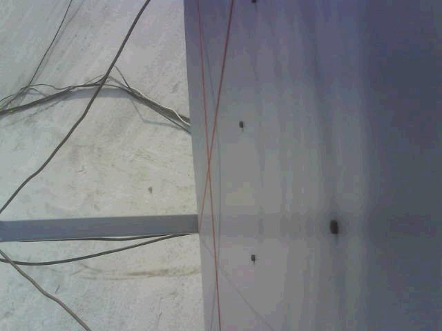

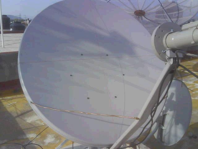

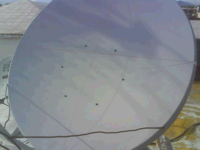

Yes, the damage is in one side, I fixed myself with a little hammer :D, and seems to be fine at first sight, but I'm suspicious the dish is bent, someone in other forum advised to use a cord in order to know if the dish is bend, by noticing the gap in the center (please see the pictures), what do you think?

4). it's difficult to tell from the low resolution pictures, but it looks like the strings you have crossing the front of the dish are touching.

4) Yes it is.

Hi all, There are news around here..I finally found that the LNB arm was bent for about 1 inch , so I just tweaked and it works better, the LNB is now placed 1 inch up.
