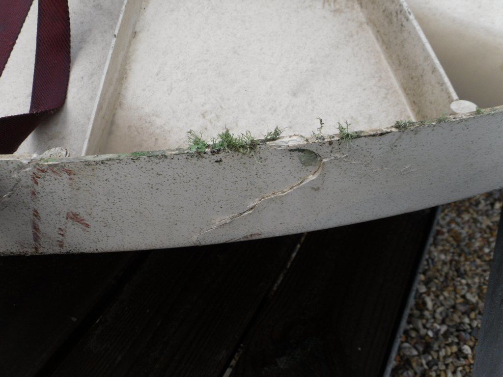

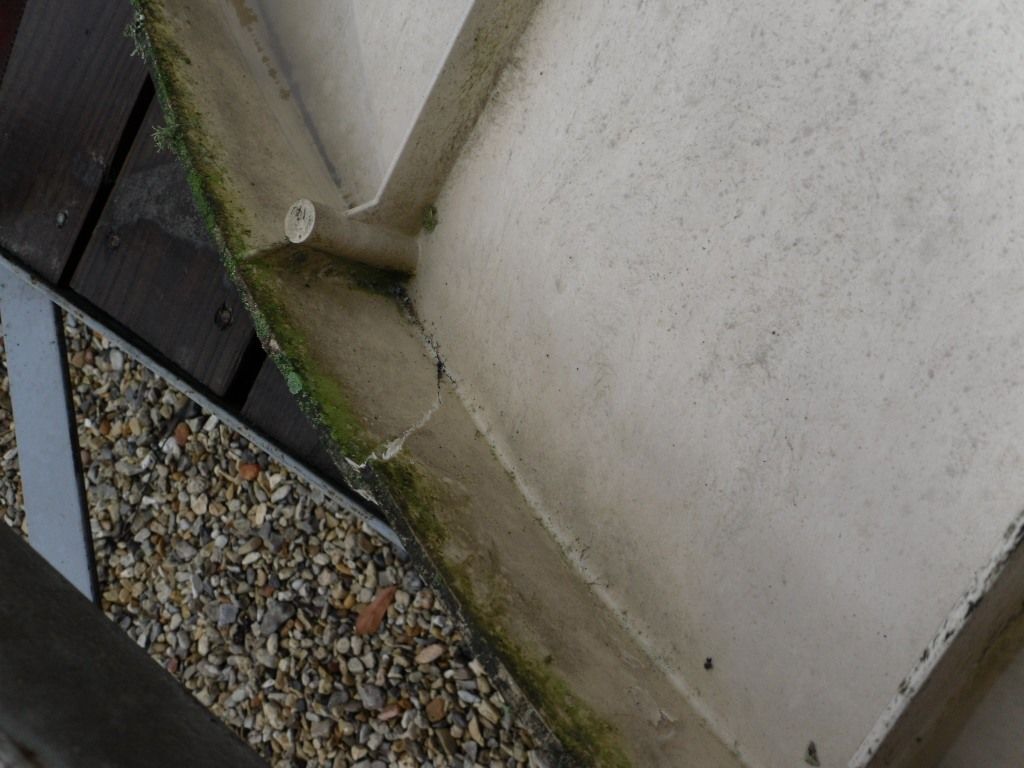

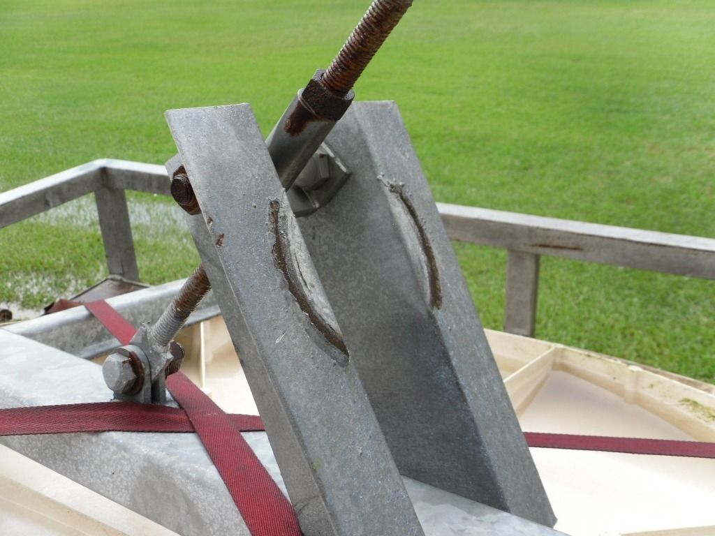

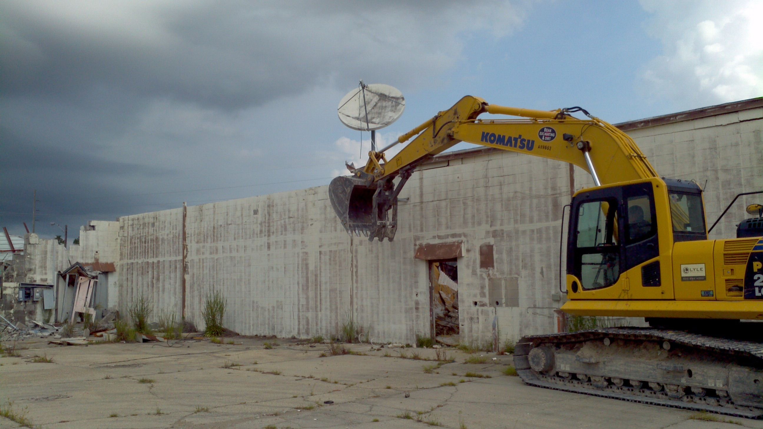

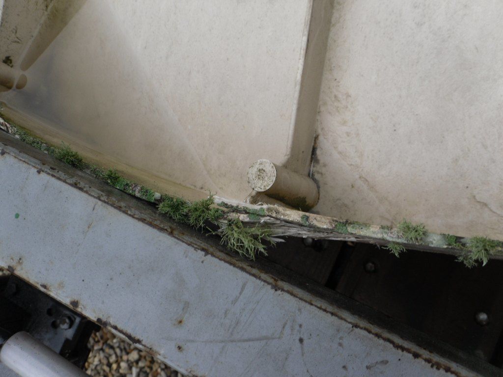

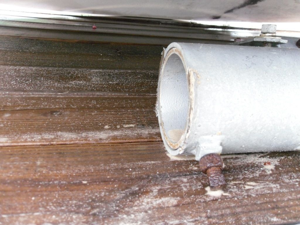

Well it worked out pretty well. the operator had to end up pushing the wall down, as the dish wasn't on a NPRM, it was bolted to the wall. When the dust cleared, the only damage was to the rim of the dish, not affecting the parabolic shape at all. picking it up out of the rubble, he bent the elevation adjuster, and broke the mount sleeve off the mount of the dish. All can be fixed pretty easily, I think. LNB arms weren't bent at all. Feeds were intact, no damage.

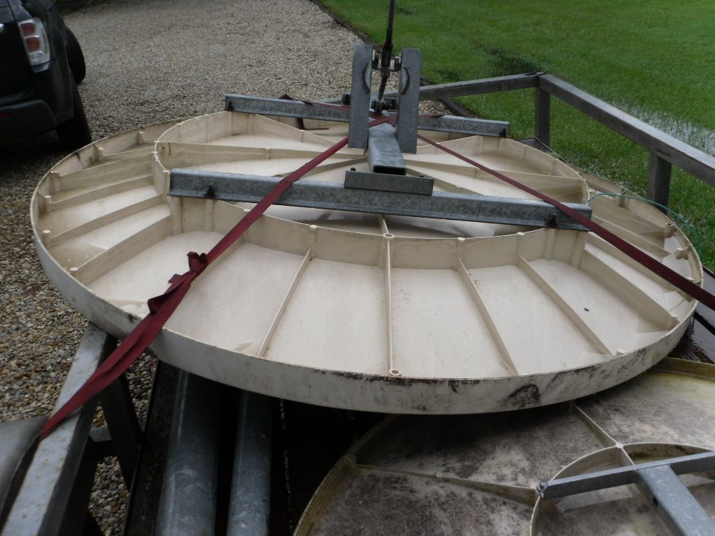

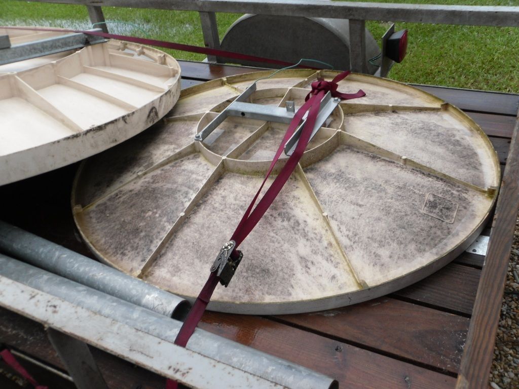

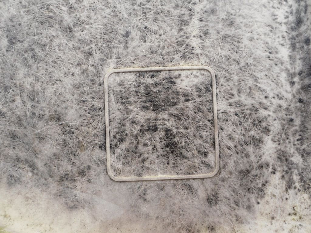

...and, not 50 feet away...was another dish. 1.2m. Operator asked me if I wanted it, I told him 20 bucks more if he could get it down without tearing it up...down it came. This is an older dish, its real weathered on the back, fibers in the fiberglass are showing, but it looks ok otherwise.

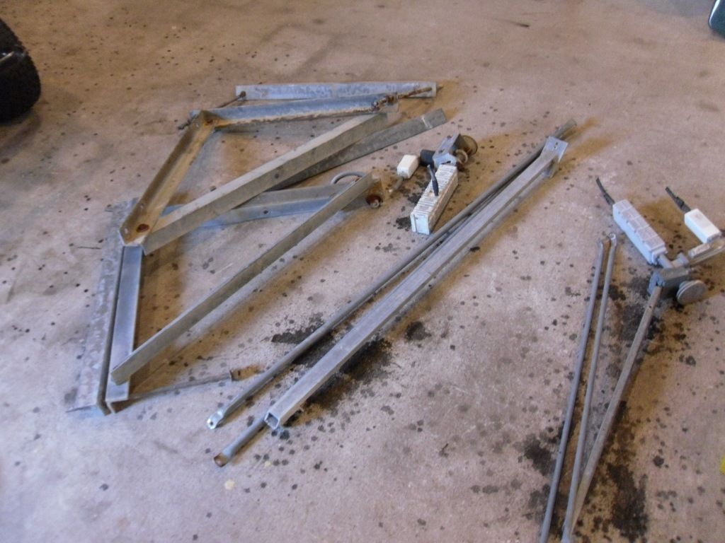

I also included a pic of the arms and LNB's for both, as well as the twisted up metal that was left of the 1.8m dish wall mount.

On the rim damage, some JB Webb on it will reinforce the dish, if you are concerned about it affecting the dish. Put on the inside side of the dish.
Did some work today, got the cracks patched with some Bondo for fiberglass, here's the 1.8 first. Still needs another coat of paint, but it looks better.
Now the 1.2.

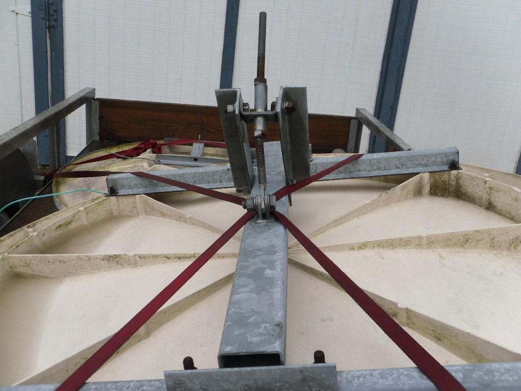

I plan on putting it in the place of my primestar 1m while I find a mount to motorize the 1.8, so I needed an adapter to mate it to my sg-2100. So....
And here's a before and after painting on this dish:

Did you shoot any on the backside?
I though you'd commented previously about the fiberglass shredding a little.
Like your DTV 'foot', too.
I've seen your previous incarnations of this design;
Am anxious to see what you come up with this time for an elevation tuning screw. ;)
This is a whole lot lighter than the original mount!
Still, let me put a bug in your ear.
I don't have any recommendation, but you might look at whether moving the foot up or down, would change the balance any, to make for a lighter load on the motor.
Your design would certainly make it easy to optimize, so let us know. :)
Great work, Stogie! That's what I had to do with the 1 meter Channel Master I rescued from that strip mall on Causeway a couple of years ago. The roofers, unfortunately, seem to like to throw these dishes off the roof onto the parking lot concrete :eek: ...
As for painting the back of the dish to encapsulate the shedding fiberglass, I used Krylon Fusion for that task.

Nice work there, if that was all the damage he could do with that big ol Komatsu, lol.
