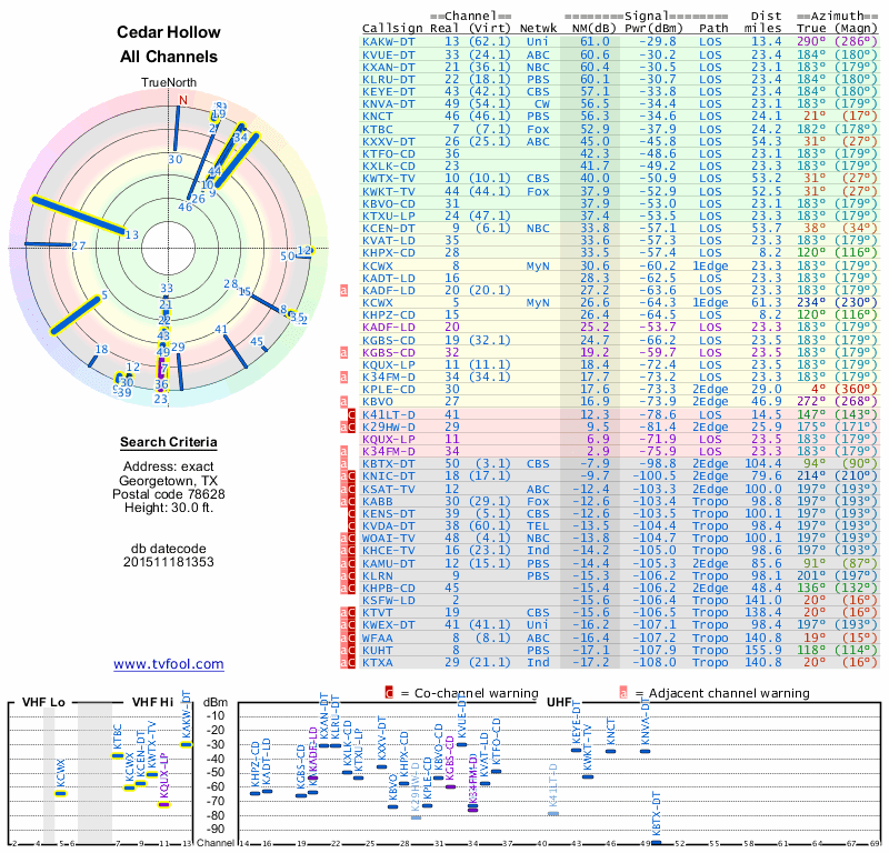

Based on my tvfool report, it looks like I have pretty good LOS to most stations in Austin, due directly south of me. (183°). So a directional antenna should pull in a large majority of the channels. Don't want to mess with anything inside the house or attic, due to solarboard construction.
TV Fool attached, can't post link since I haven't posted enough, i've found out.

You will need a hi VHF and UHF antenna for your due south signals. You probably won't need a pre amp but you may need a distribution amp. How many TVs are you going to split the signal to?

http://www.solidsignal.com/pview.as...UHF-HDTV-Antenna-(HD7694P)&c=TV Antennas&sku= <<Should do IMHO. Should also get some from the back side, How much is an unknown.

If preferring a multi bay think the 8 bay is real overkill and they don't accommodate VHF that well. IMHO a DB4 style for UHF and a yagi for VHF Hi (7 thru 13) would be a 'good fit'. Combine with a UV Combiner (NO induced mautipath)

So I got the antenna (the 7694) set up in the attic, pointed towards Waco, picked up 26 channels. I am able to get all the major networks from austin and some from Waco, except for KCEN and KWTX in Waco. KCEN has Me-TV and This TV on virtual channels, which aren't on the Austin networks, so i'd like to get them picked up as well. Most of the channels are in the 70-75 signal strength on my Dish OTA module as well.
Would a preamp help bump up the strength of the channels and possibly get me the 2 waco channels or is my best bet trying the antenna outside? Or is it not even worth trying, due to low transmitter power? Hoping to lean on you guys for advice before I take down the attic setup and try it outside.

Best bet is to try outside...as both are on VHF (KCEN is on RF9 KWTX is on RF10) to see how (or if) it works. They are 50+ miles away (per your tvfool) but show decent numbers. You can always try an amp too but putting the antenna in the attic cuts approx half your signal

So put the bad boy outside, got all the same channels plus a few more. Picked up 3-1 and 3-2, which is real channel 50 out of bryan/college station, which says on tv fool it is a 2 edge at a bit over 100 miles away, still not getting the 2 other waco stations I wanted. Shocked I can get the 2 edge 100 miles away but not the LOS KCEN and KWTX at half the distance. Any thoughts from the experienced guys on here? Is it the UHF vs VHF?
Yeah its probably UHF vs VHF. I forget what antenna you are using. Some antennas that are combo units (VHF/UHF) are more emphasized on UHF and the VHF is kinda "an afterthought" with range not as strong as UHF
