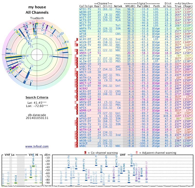

heres a report
So far all the posters like cats, that is the easy comment. How many TVs are you planning to connect? From your FTA listing I assume you are familiar with RF technology, my suggestion is extend the cable from the rabbit ears with a F-81 splice. Move the rabbit ears outside and as high as possible with a clear shot to the WEST/NORTHWEST and rescan the channels. I am expecting you will gain usable channels. The next question is are you interested in the additional channels? Then the next problem will be designing your distribution system or just adding rabbit ears where you need reception.
It looks like you could receive most of the same stations that I do here. I'd say that if you're getting that good of reception off of rabbit ears, then a better antenna would probably pull in more. On rabbit ears here, with no pre-amp or anything, all that comes in watchable is WHPX and WEDN unless I do as Boba suggested and put it way up high. With the HD8200 U and rotor, pre-amp and distribution amp that I have, I get somewhere between forty and fifty channels.

Since they are 'all around', and most are good signal levels, I think I'd try a Stealth Hawk DIY project. Omni directional. I wouldn't expect the weak ones with Co-channel, but may get some that are flagged with 'adjacent'.

Adjacent or co-channel: If the "offending' station is more than 60° away from the one you want, the 4 bay 'bowtie' designs may offer enough rejection of the offender. The signal level of the offender would also have to be considered. Should be weaker than the desired station by (I'd like to see) 10db. That and the off axis 'rejection' of the antenna should/may give you the margin needed.
