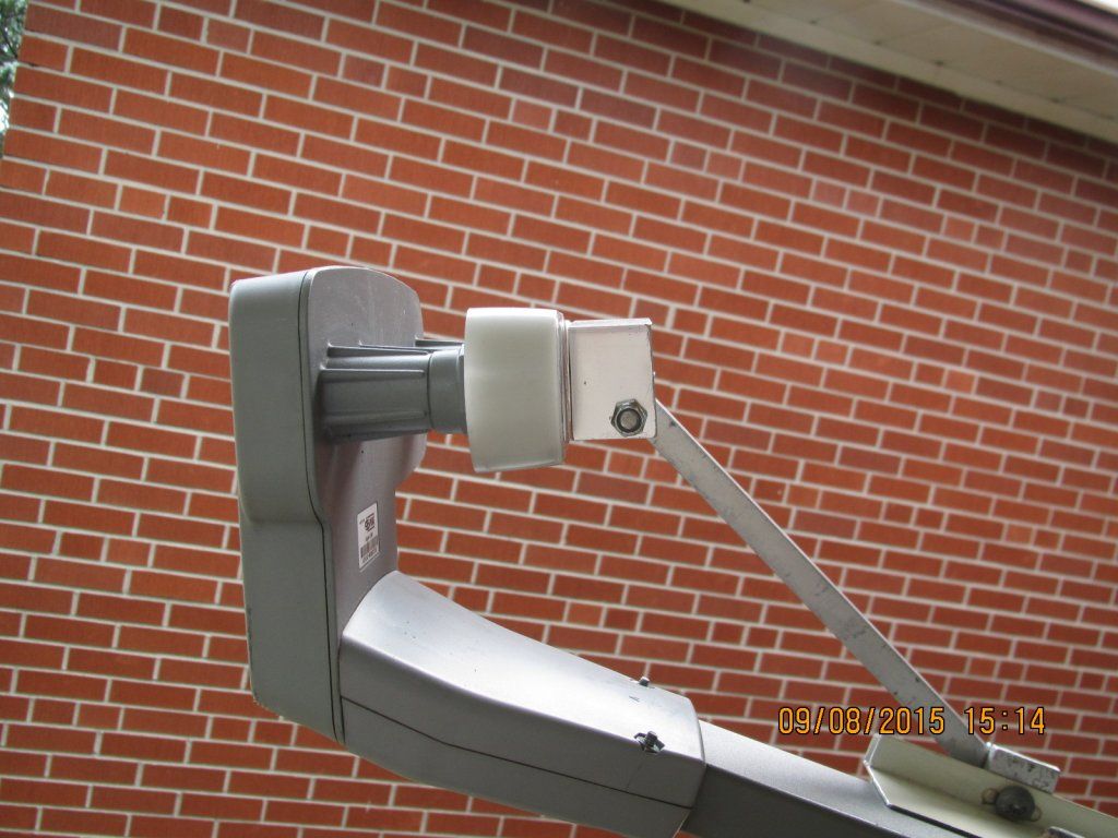

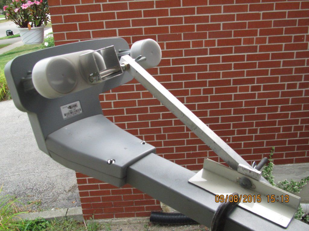

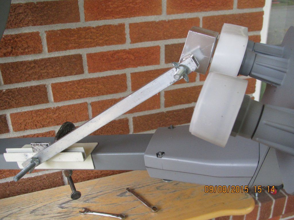

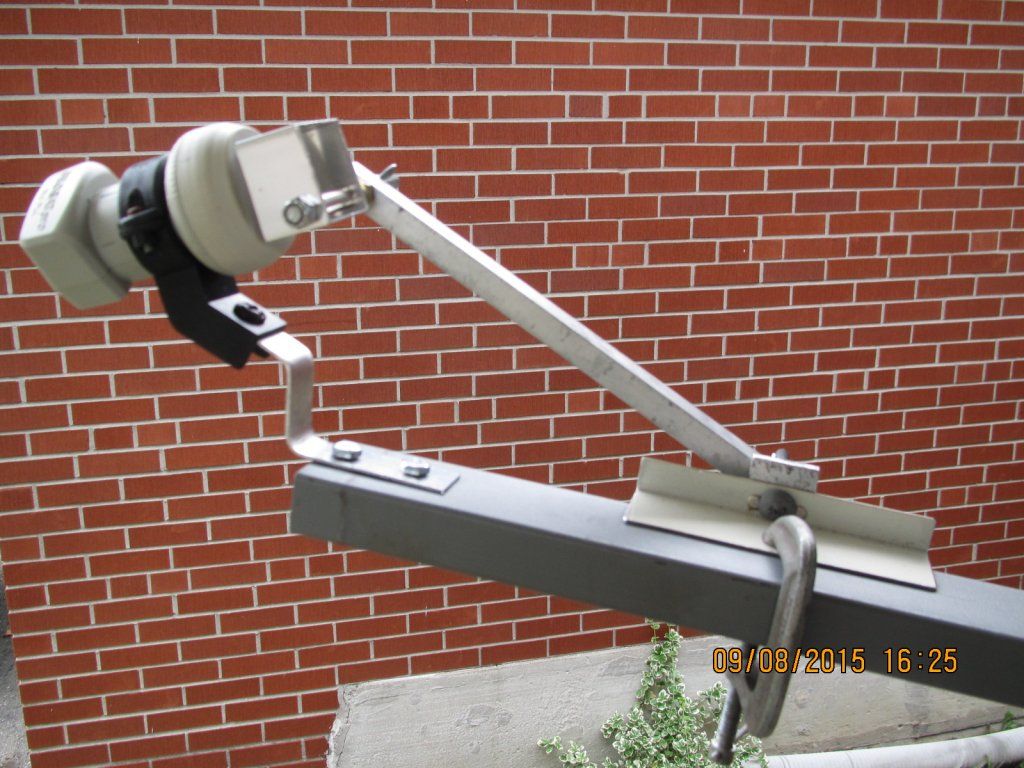

A jig for proper positioning of replacement LNBF
polgyver
Creative Tinkerer
Sep 21, 2010
489
371
Toronto
This jig can be adjusted for usage on various Ku-band dishes for FTA adaptation.
The short piece of square tubing can be adjusted to stay close to old LNB, about 1/8".
After removing the old set of LNB's , a new one can be placed in right spot, as the jig stays out of the way.
